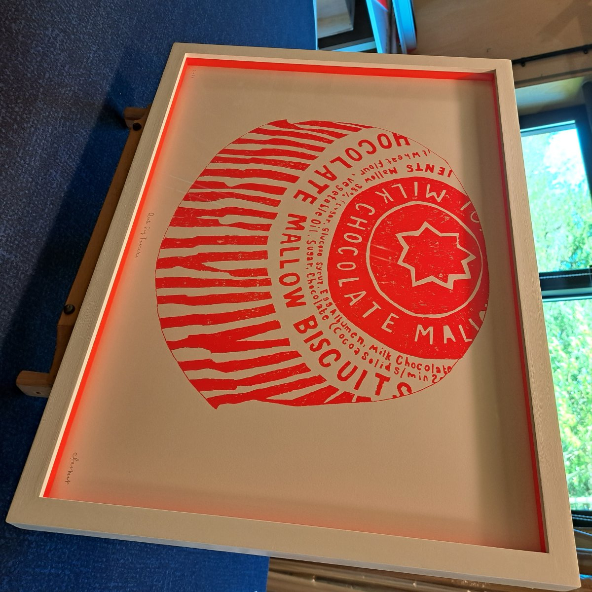

Here's my not Friday show and tell.
I've been dying to use a flouro mountboard!

Love it! Got a sheet of each colour from Centrado in and still haven't found a job for them yet!

That's a fine bit of picture-framing you've done there.
From what I'm looking at, you've made a frame with a flat bare wood moulding and painted it to colour match the artwork.
Very clever!
Did you mix the paint from artist's tubes or other?
How was the red spacer/slip done? Is that the 'flouro' mountboard you were talking about?

Thanks!
@vintage frames, a tin of F&B this time.
Yes, the flouro spacer is mountboard glued to foamboard and cut on the CMC.

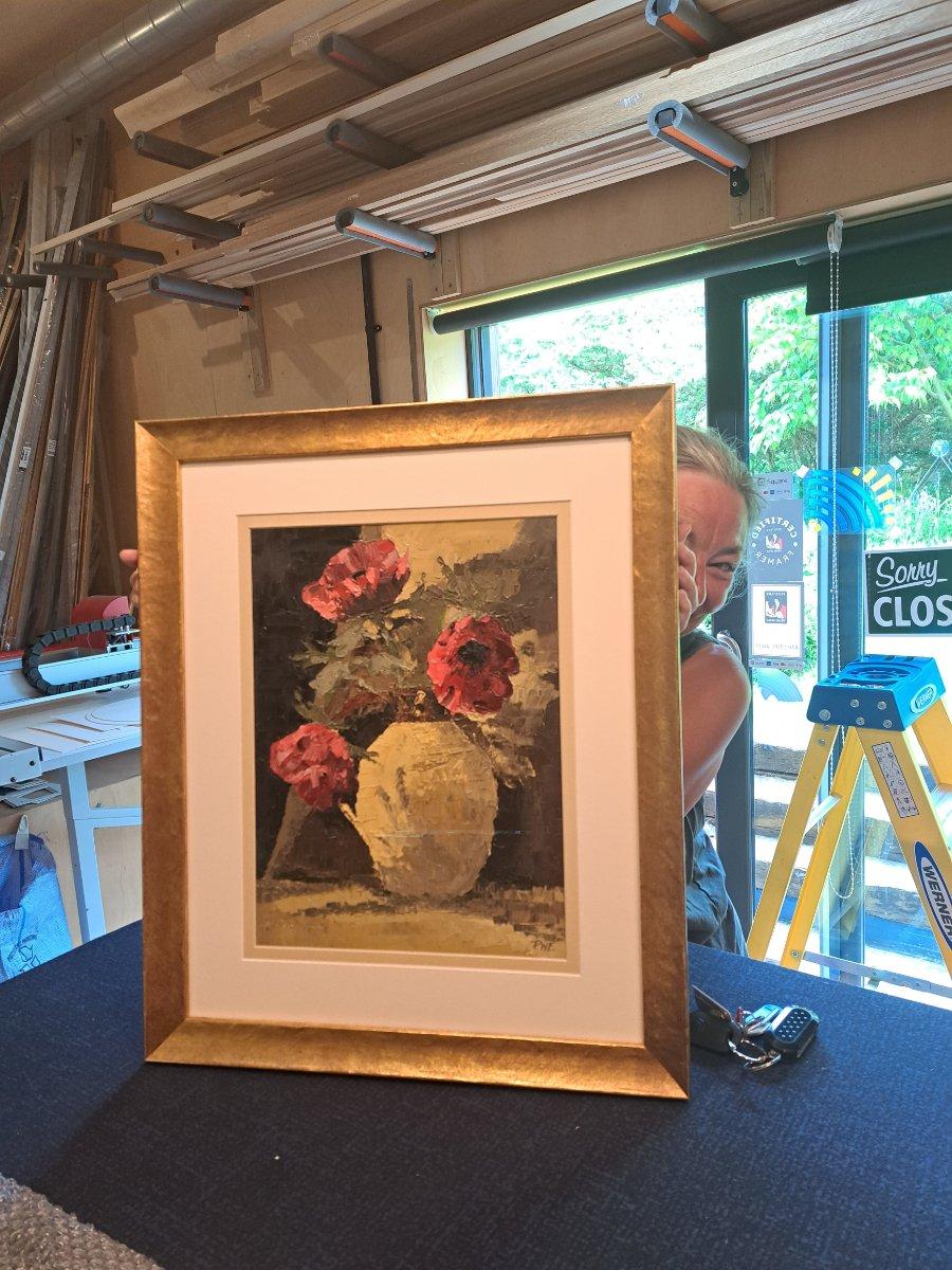

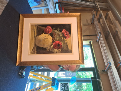

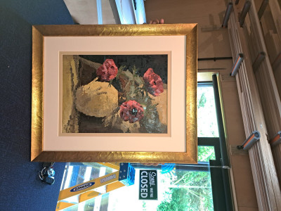

Happy Friday!!!
Shy customer collecting today.

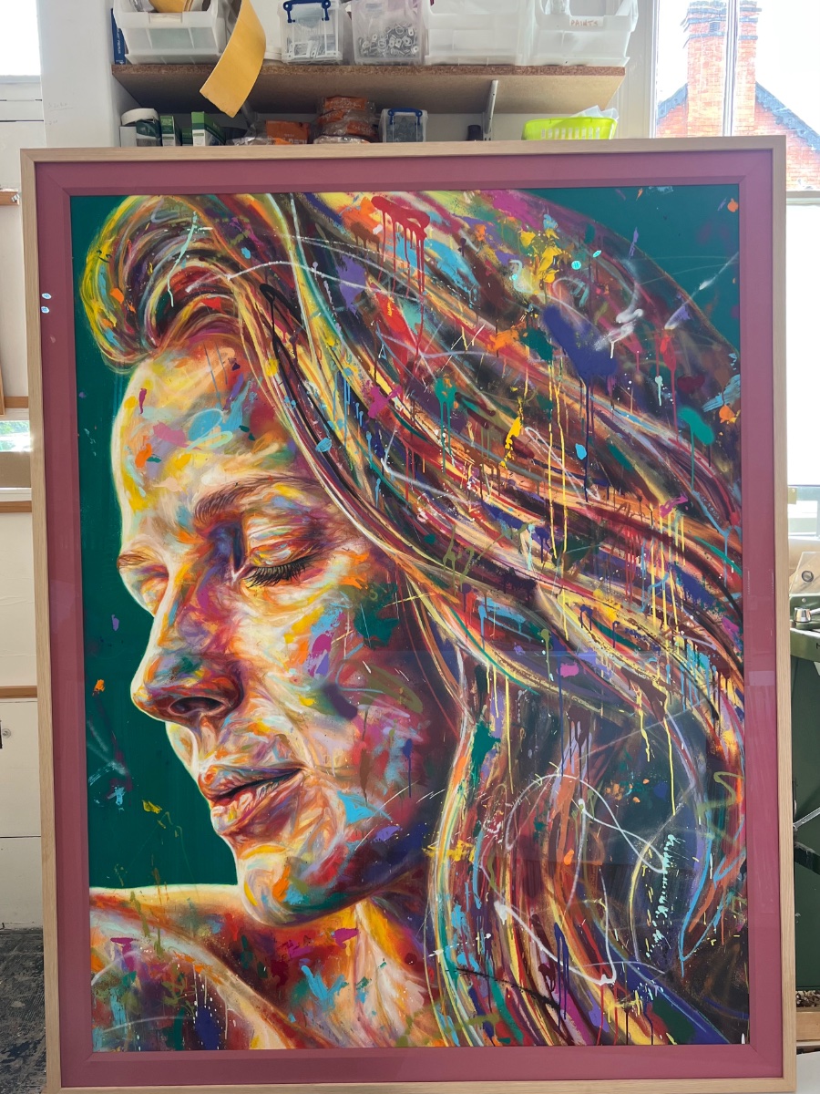

We completed this one yesterday. Canvas stretched over custom bars, wide wooden slip painted “dusty pink”, deep rebate oak frame, sub-frame inside and Lifetime acrylic glazing.
The outside dimensions of the frame are 1520mm x 1920mm - we checked it will go through the door.

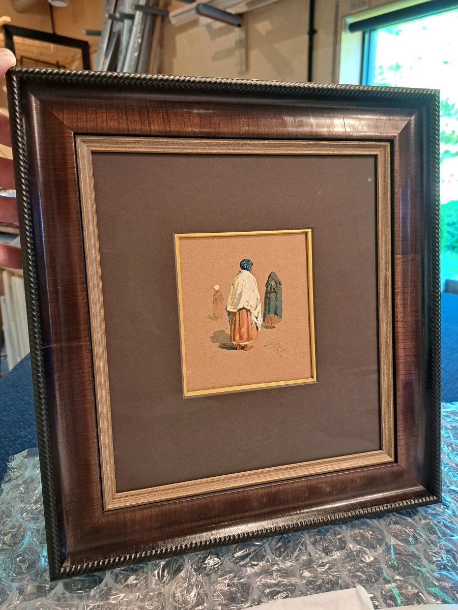

A regular customer whose ancestor was the Scottish painter Erskine Nichol (1825-1904). He buys anything he finds of his online, brings it in and leaves it all up to me. This came in with a pretty rough gold hand painted mount. I decided it would be nice to reuse it, a nod to the past.

I like that a lot! What is the frame, please (I think I will want to use that)?

YPF It's a Larson "Intermezzo" 371560? And a Prague fillet.
