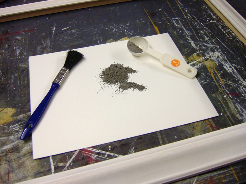

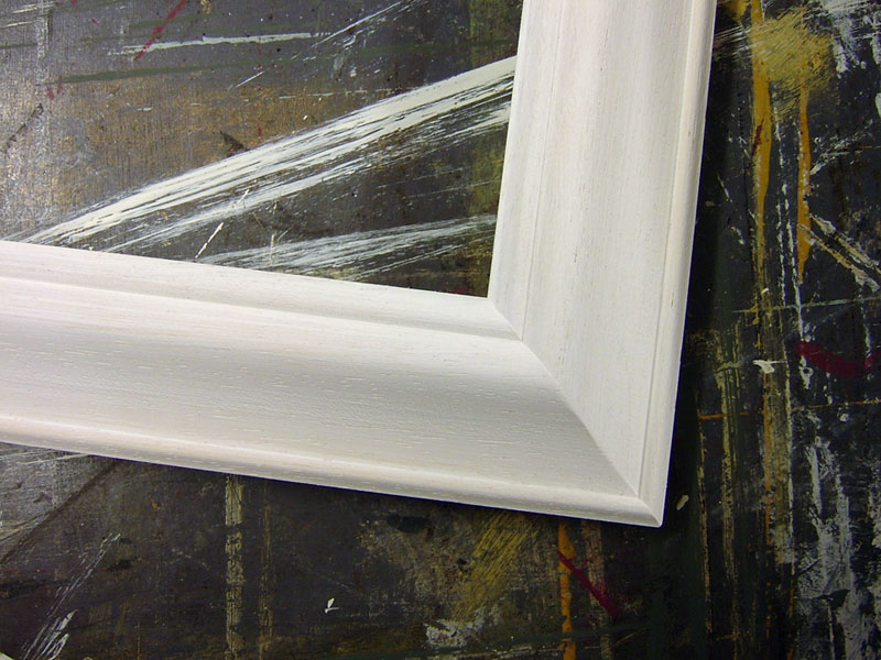

A nice simple finish I like is with white paint on obeche and rottenstone. After a couple of coats of white matt rub on some clear wax and before it dries dust with plenty of rottenstone and then buff up with a soft cloth. To tone down the effect you can rub some lime wax on and rub off again with the clear wax.

Sorry to bump the thread but can anyone tell me what profile that is?

Sure, Rose & Hollis A77 obeche, page 17, 45mm wide with a 14mm rebate.

Out of curiosity what do you use for your white paint? I find that not all paints are the same.
I like the durability of a good quality acrlic paint, but I don't like a glossy finish when it dries, so I like to mix an acrykic paint white a chalky emulsion. I don't measure the exact ratio, but it's just gesswork of an approximate 50 / 50 mix.
I may just be me, but I feel that 100% acrylic paints can sometimes look and feel a be plasticy. I'm always looking for the muted and slightly dull effect where the frame has an old look and feel about it. Another somewhat similar moulding is Simons M0099B which may be of some interest, if you ever need something similar in a smaller profile.
Another colour which looks quite nice with rottenstone is a sort of off black made from brown and black. I make it with Craig and Rose clove brown (or was it spice brown) and black. Be careful, as you mix it, it does not need as much black as you might think!

One of my first ventures into hand finishing was very similar to the OP example. I even used the same profile.
I used white acrylic gesso which dries fast and is as hard as nails. This stuff is nice and thick so it holds brushmarks. I would typically gesso an entire length and brush along the length in one go to form 'tramlines'. Later I got into stippling and other textures. A thin wash of a colour, brushed on quickly an wiped off leaves a very subtle tint to the surface. I would then rub back with wax an wire wool. This imparts a soft grey tone to the whole thing as the solvent in the wax mixes with particles of the steel.
I don't use white acrylic gesso any more. The good old ripple paint is better. Easier to sand. But what I do use often is Black acrylic gesso.
One of my favs is to apply it using criss-cross brushstrokes. Gives a subtle but striking effect. So much more interesting than a smooth, flat finish. Adding light washes over the black also gives nice results. Thin white over black leaves a deep blue cast.

I use mostly Farrow & Ball sample pots but also have a few colours from the Plaka range. This job was F&B Tallow 203. I must get round to trying some of the acrylics and the white ripple that Prospero favours.Not your average framer wrote:Out of curiosity what do you use for your white paint?
