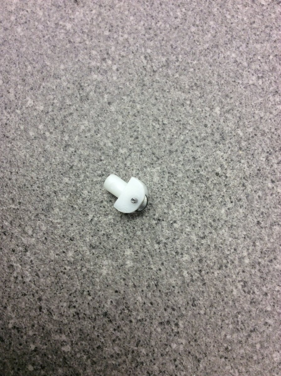

Re: Keencut system 4000
There are two types of glass cutter, the earlier one is in a black holder it can be obtained through Lion individually or Keencut (code TCGCW £11.16 each sold in packs of 5), if it is the later one in a white holder it is no longer available from Keencut but it is available from GlassParts in Southampton on 800-975-3436 https://www.glassparts.co.uk/plastic-wh ... arch=white.
Sorry link should be https://www.glassparts.co.uk/plastic-wh ... white-wire
pepper wrote: Thu 19 Mar, 2020 9:29 pm There are two types of glass cutter, the earlier one is in a black holder it can be obtained through Lion individually or Keencut (code TCGCW £11.16 each sold in packs of 5), if it is the later one in a white holder it is no longer available from Keencut but it is available from GlassParts in Southampton on 800-975-3436 https://www.glassparts.co.uk/plastic-wh ... arch=white.
That's a life saver. Just ordered a couple, do you know if they're definitely the right ones? I noticed there's a few different cutting wheels on they're site that look the same
Just recieved mine in the post and it works perfectly. Many thanks for the tip, saves me buying a new wall cutter now.
