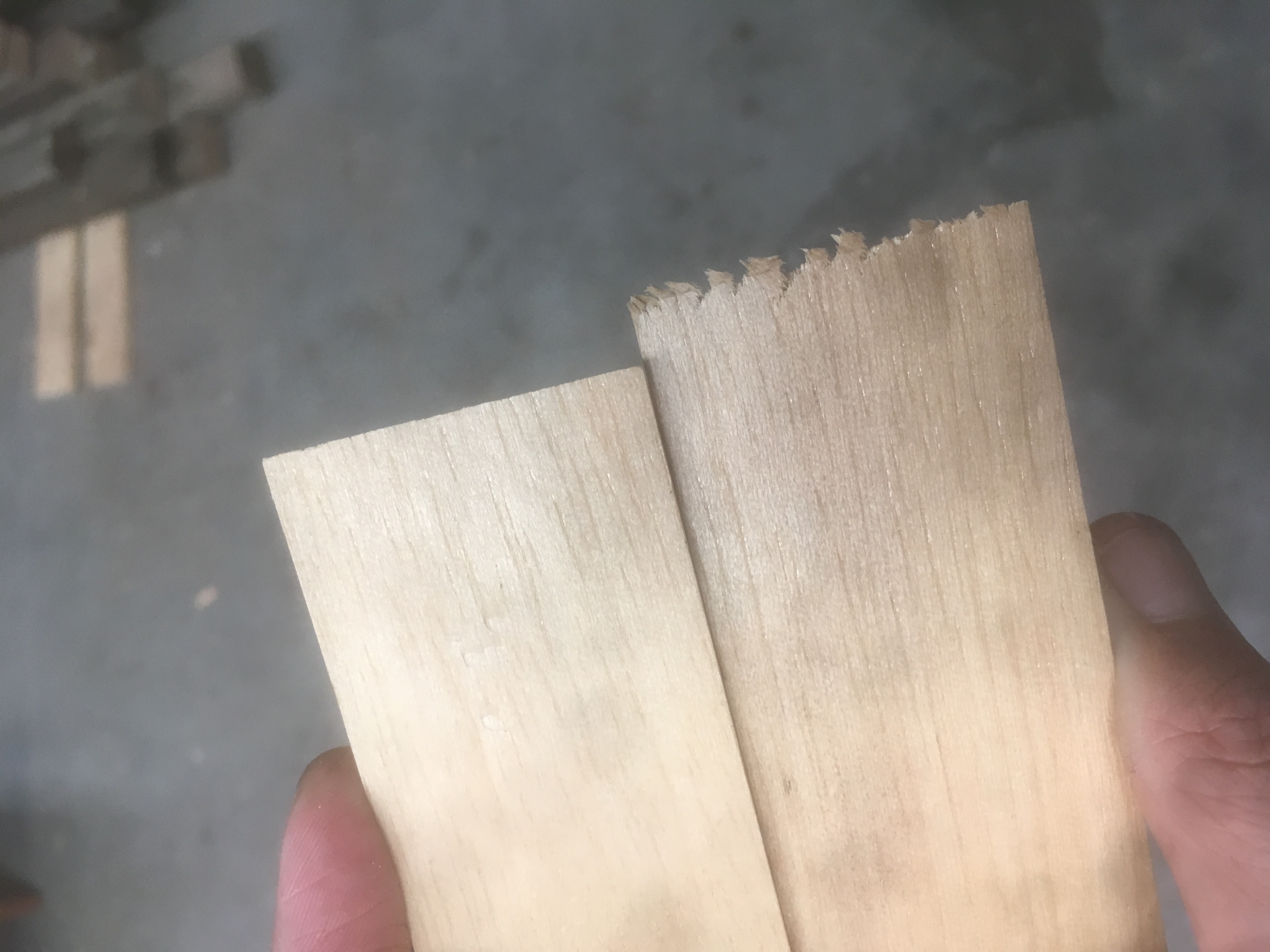

So the blades are being properly hollow ground by a reputable grinder so hopefully it will be the answer to my problems.
As for the moulding type, here's a picture of the exact same moulding (from the same metre peice) one was cut a week ago, one was cut today with no changes to the machine, at least that I'm aware.
I've tried a Black moulding that I had lying around and it actually cut quite well but every other moulding I have, all from very good suppliers and from timber I have routed myself, all turned out the same. This would usually rule out bad moulding but I have cut every single piece of timber I tested today weeks ago and they all cut perfectly.
p
So something has definitely happened to the guillotine itself, I just have to figure out what.
I'm hoping it's the blades.
My only theory so far is that the blades may not have been tightened and could have budged from their correct positioning when trying to cut something with a bit of force. I have sent the blades I originally used off to get sharpened so unfortunately I can't refit and test the same blades...yet - and all the other sets I have aren't great.
Thanks for your help though guys
p

Just out of interest did you try putting a little slip of mountboard between the fence & the back of the moulding. Looking at the photos I'd say your blades needed a sharpen or nudging them forward just a little, also I've had lengths of plain wood cut great at one section and awful at another. Welcome to the world of tearing your hair out.
Re: Morso guillotine - cutting poorly all of a sudden
I can't really say for sure what type of wood your moulding that is not cutting properly is made from, but I'm guessing that it could be an Obeche moulding. If so, then it is not all that uncommon to find sections within a length of moulding, where for what ever reason the wood ends up cutting like that if you are using a mitre guillotine. Wood which cuts like this is commonly referred to by framers as snot wood, or even Wheetsbix wood.
That same wood would almost certainly cut just fine on an electric mitre saw, but using a mitre guillotine is quite different. It could just be that you've got a bad bit of wood and illiminating other possibilities is the usual way of figuring out where the cause of the problem lies.
