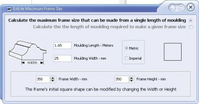

The Maximum Frame Size calculator, will do the sums for you. Not only will it calculate the maximum frame size that can be made from a given length of moulding, but it will also calculate the (theoretical) length of moulding required to make a frame of given dimensions.
Just enter the Moulding Length and Moulding width and the app will calculate the largest frame that can be made from that length.
Also, by selecting the second line of text and entering the Moulding Width, Frame Width, and Frame Height, the program will compute the length of moulding required to make the frame.
See image below:-
Download and open the zip file, and place the single executable MaxFrameSize file in any suitable location - it is totally self-contained, so no installation required.
