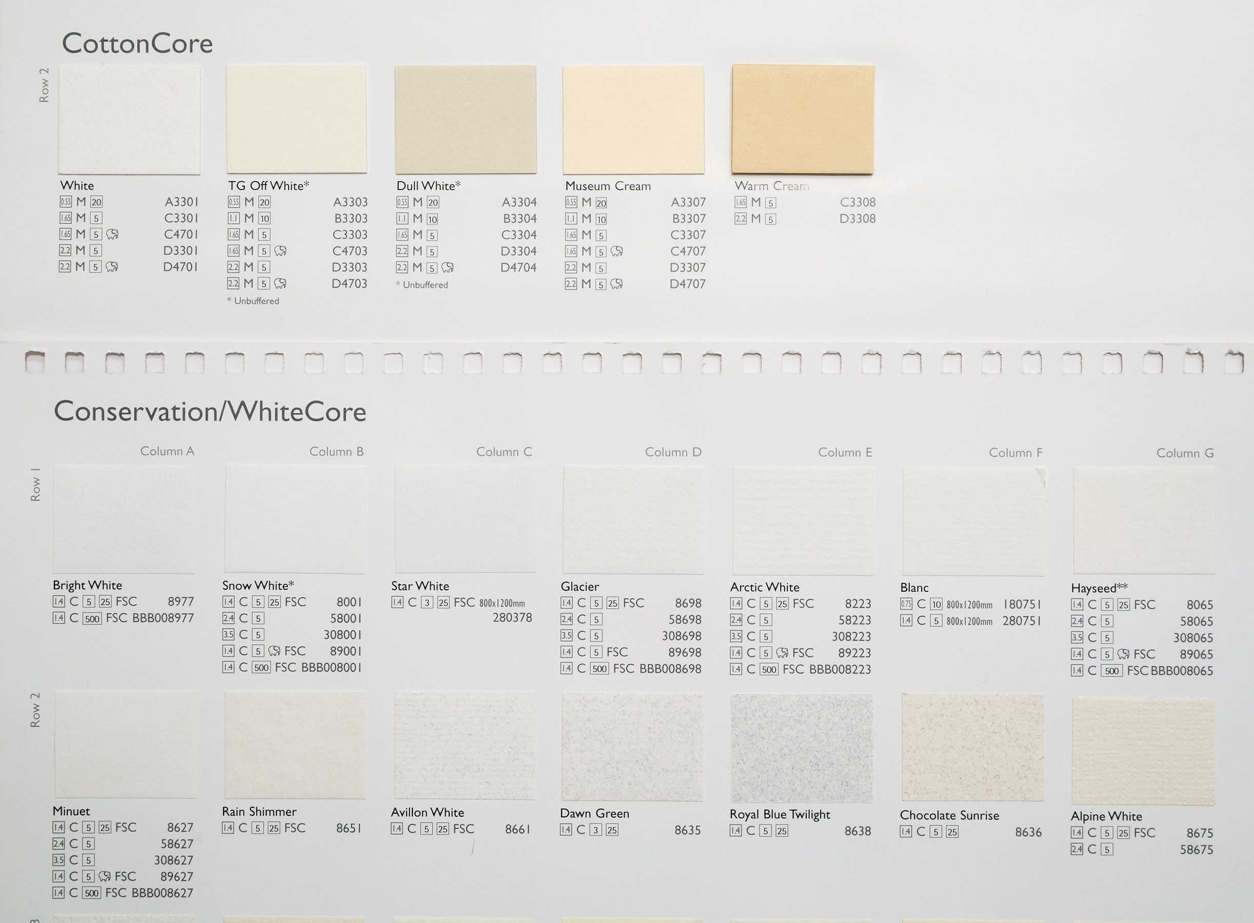

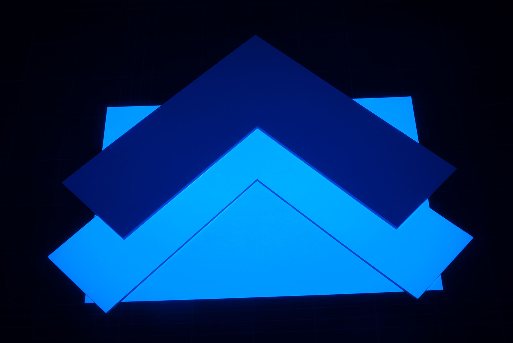

Thought I would bump this topic with a couple of photos to illustrate what I'm on about.
The two sample mountboards are both white with one being described as meeting conservation level and the other museum level (the sample on top). They are photographed on a bog standard sheet of white paper that does contain OBAs. The first photo is under white light and the second a UV light. It is clear to me that the conservation board contains OBAs. If it doesn't, then why does it fluoresce under the UV light? You can also see that the core of the conservation board does not fluoresce. The backing paper also does not fluoresce. So I wonder if the standards do not apply to the face papers and only apply to the core and backing papers only?
I'm just curious and thought others maybe interested.

A forum member has asked me to clarify what the photos above show
Optical brightening agents (OBAs) fluoresce under UV light.
They are chemical compounds added to fabric, papers, paint, plastic, washing powder and all sorts of things to make them appear whiter than white. They absorb ultra violet light and re-emit it as visible blue light giving the impression of it being whiter. This process is known as fluorescence. Under normal white light, which will contain UV light, the materials that contain OBAs will fluoresce and emit blue light as well as the reflected white light, giving the impression that the material is whiter than white. Generally, when we see something white that has a bluish tint as opposed to a yellowish tint, we perceive it as being whiter or brighter.
Because the human eye can't see UV light it is invisible. UV torches that you can buy like the one I've been using, have a filter to remove most of the visible white light. The light the torch emits is dark blue and contains invisible UV light. If you shine this torch light on a sheet of white paper, the paper reflects the blue light and therefore appears blue. It also reflects the UV light but we can't see it. However, if the paper contains OBAs, then they will absorb the UV light and re-emit it as brighter blue light. The more OBAs present the brighter the emitted blue light.
So, looking at my photo, the range of cotton-core museum boards in the top row are all dark blue because they have no OBAs in them at all. The two rows of conservation/white-core boards contain varying amounts of OBAs. All these boards are marked with a 'C' indicating they are conservation. Bright white, Snow white and Artic white are fluorescing the most and are therefore saturated with OBAs. Star white and Avillon white probably contain a fair amount of OBAs and Minuet contains some OBAs.
The thing is, OBAs can break down over time and stop working and even discolour the material they are contained in. However, we may never be aware of this deterioration and they probably won't have a detrimental effect on any artwork mounted with material containing them. But I will still avoid inkjet printing papers that contain them as I don't need whiter than white paper!
And the other thing is; the FATG says the following about conservation mountboard standards:
"2.17. The stock must be free of optical brightening agents."
So, if a mountboard is sold as fully meeting the FATG conservation standards how can it have OBAs in it?
Interestingly, Arqadia now lists Bright White as White Core Standard board on their website but Snow White is still listed as conservation as are the others. I have contacted Arqadia and asked if Snow White contains OBAs.... I'm awaiting a reply.
I need a cuppa tea now

Snow White and Arctic White are now listed as White Core (WC) on their website.David McCormack wrote:Interestingly, Arqadia now lists Bright White as White Core Standard board on their website but Snow White is still listed as conservation as are the others.
As a side note, I almost exclusively use Arqadia mount-board and their other products and think they are a good company to deal with, even when a problem does arise they deal with it very well. This topic is more about my curiosity and not a stab at Arqadia in any way at all.

Thank you for flagging this, David. We have now checked the relevant product information with our supplier and I can confirm that you are absolutely correct - while Snow White and Arctic White contain no optical bleaching agents, they do contain optical brightening agents, and do not therefore qualify as conservation products.
We are now just completing a review to ensure that we can give customers a 100% guarantee that none of our conservation products contain any optical brightening agents in any part of their composition.
We take full responsibility for this misunderstanding around "OBAs" and are in the process of amending all records accordingly.
Meanwhile, we want to stress that the presence of optical brightening agents will have no detrimental effect on artwork. No gasses will be omitted and there will be no degradation whatsoever.
I apologise for the confusion around OBAs and, albeit unknowingly, for providing inaccurate information.
I have just spoken to the FATG and advised them that we have changed the description to Whitecore. Unfortunately our selectors will not be changed until we re-print.

Thank you Pauline for confirming the presence of OBA's in those two boards and thanks for posting on the forum.
