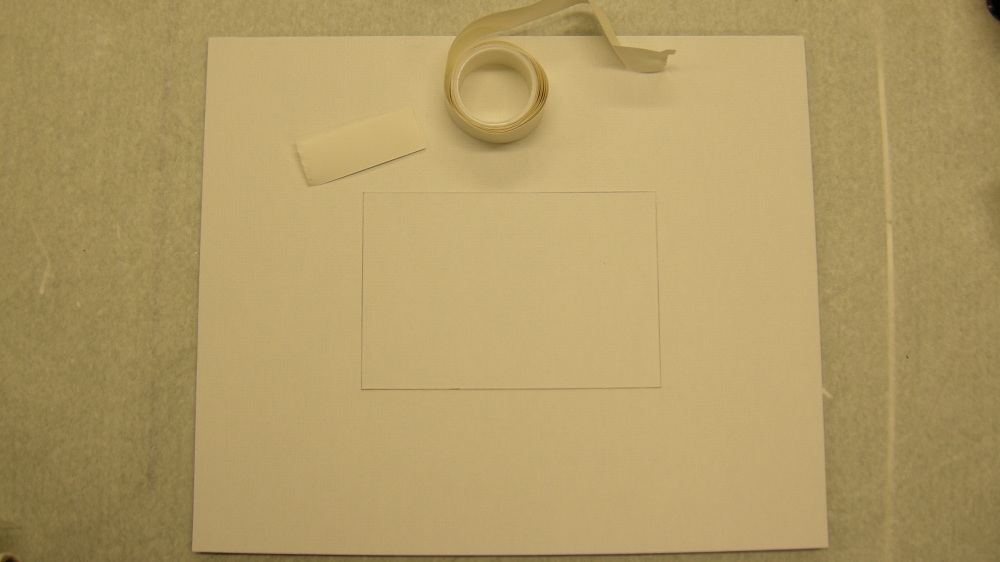

This isn't all that new a method but I first read a description of it on TFG the other day and made this as a POS example.
First cut a mount (double mount in this case) as normal, to overlap the image by however much, plus an under mount. This is a coloured core board to help with the explanation.
platform mount 001.jpg (116.86 KiB) Viewed 16570 times
But instead of hingeing the window mount to the under mount, cut an aperture in the under mount one millimetre larger than the paper, preferably a 90 degree cut too, but bevelled is OK.

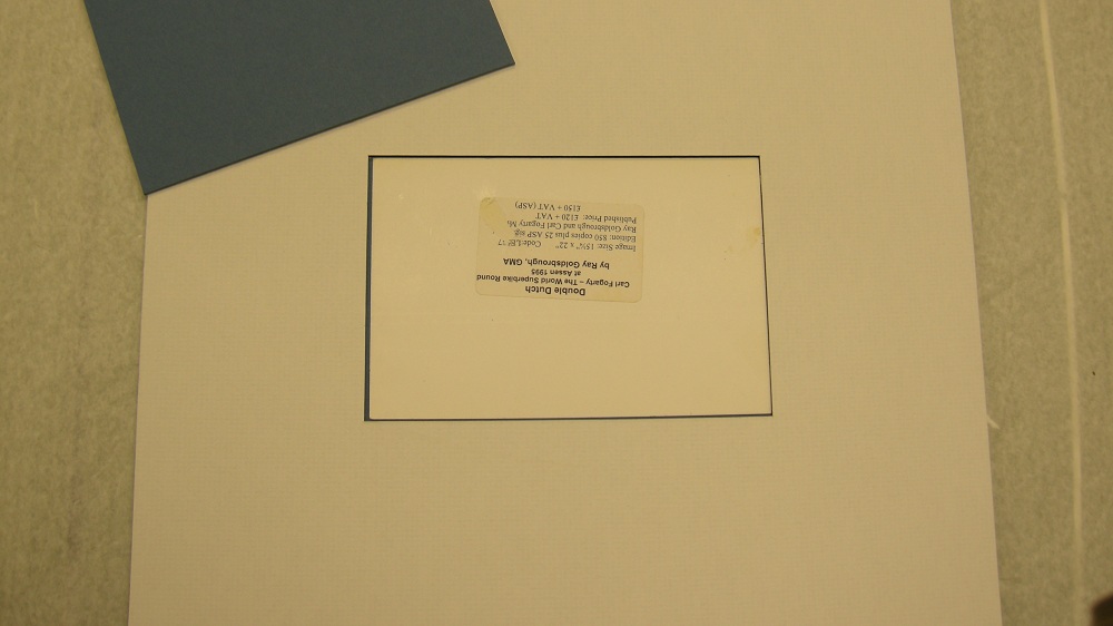

Glue the under mount to the back of the window mount and glue it RIGHT up to the aperture in the under mount. Starch paste is good, but PVA or something like evacon would be OK, depending, and if you have a press, use it; with no heat. Weights are fine if you don't have a press and some ATG tape at the extremities to hold in place while the adhesive goes off is fine too. The blue aperture below is the back of the window mount
platform mount 002.jpg (128.54 KiB) Viewed 16570 times
Drop the artwork in.
platform mount 003.jpg (98.93 KiB) Viewed 16570 times
Drop the under mount's fall out in to its aperture and tape over the corners with gummed linen tape. (or something else - up to you, again "depending"). I haven't done that because I want to show customers how it works.

It's just a non-adhesive method. Even the best hingeing techniques and materials do something to the artwork, this does nothing; there are other methods that don't either, like edge mounting strips. Certain types of hinge may also be removeable with water, others with solvents, but by who? Nothing to remove here.
Although it's a conservation method it's also a simple and cheap method and there may be other reasons than value of artwork for using it. Some examples - a postcard or things that have something on the back that a hinge would cover/ruin; something on almost transparent paper; something totally transparent like acetate; something where the hinge would be behind the image area and its shape would show due to the type of paper .... lots more.
