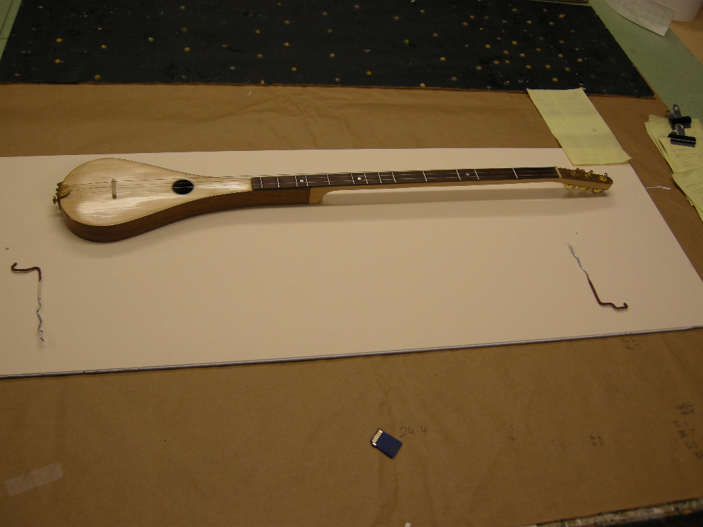

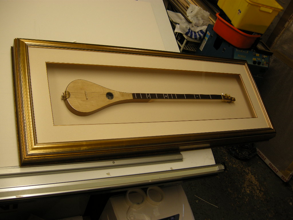

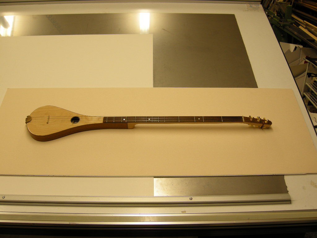

Customer wants to be able to take this out of the frame to play it. I made two formed rods from a coathanger, covered the ends with shrink tubing and painted them.
The mounting board is bonded to correx
The channels that the board is made from are handy for holding the rods, just remove the surface above one, or as many as you need. The rod is made 'squiggly' to give more purchase and is stuck in with something that dries rock hard, to prevent swivelling.
.... and that's it mounted.
Should finish this tomorrow - it's going in a slip-over frame.

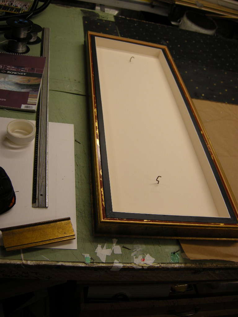

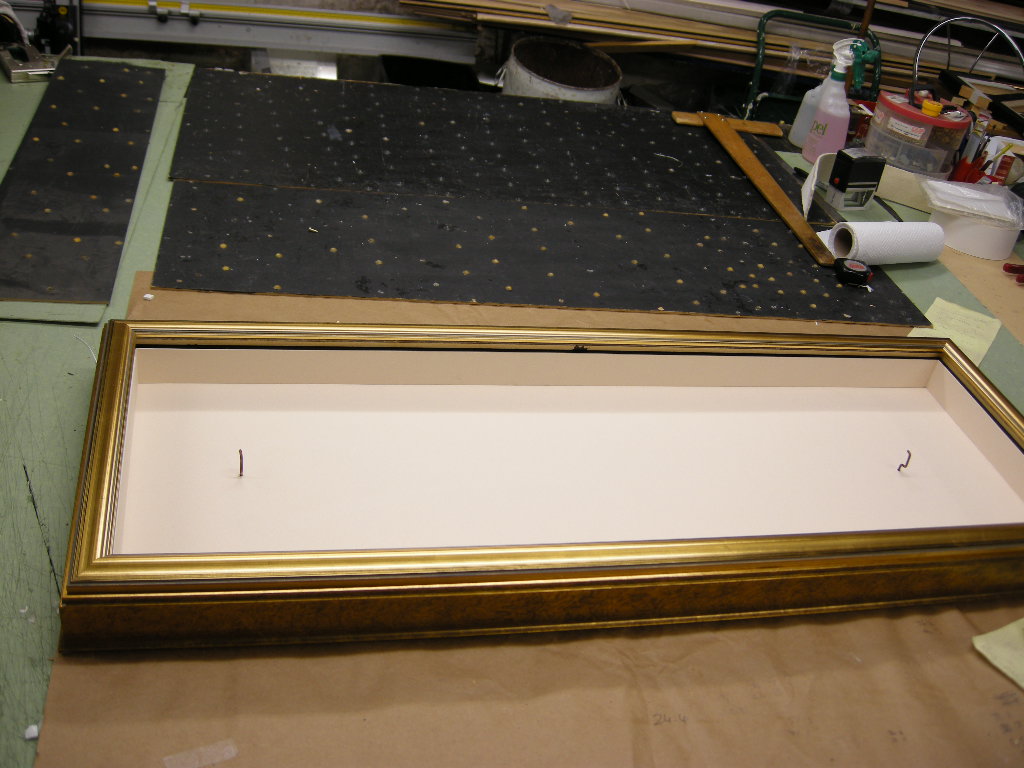

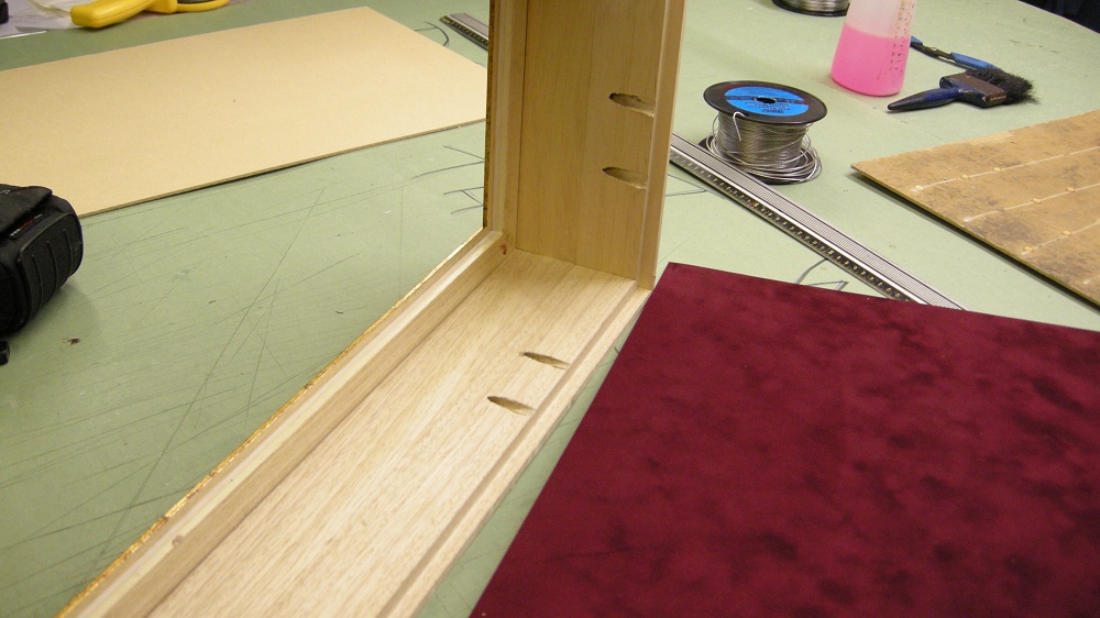

Doesn't look like I will get this finished today - anyway - here's the box that will fix to the wall with mirror plates which the outer frame will conceal. Lined with same colour board. Moulding used is the flat one you see in front of the box, but mitred on its side.
Re: Gig Stick
Outer box done - arqadia 612 247 000.
Re: Gig Stick
Capped.
Re: Gig Stick

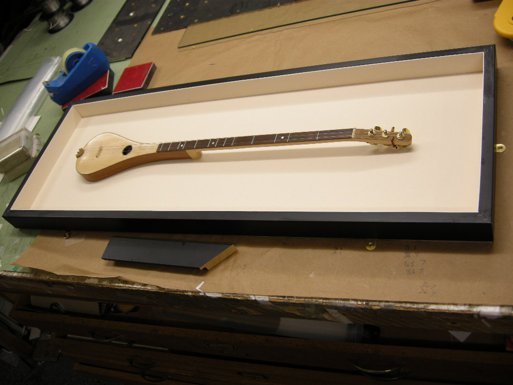

All done.
The mount conceals the inner box and also provides a space for the customer to store the shoulder strap.

John what is the capping moulding please, and does the gig stick stay put with gravity or do you melinex around it to hold it in place.
Looks very classy.
Keith
Looks very classy.
Keith
Re: Gig Stick
This is the capping moulding http://www.arqadia.co.uk/productdetails ... =216620000
The thing just sits on the two hooks and can be lifted off whenever the customer wants. I can't store it for collection like that as I don't want to walk about with 3 loose bits.

How does the outer box fit to the inner box once that is screwed on the wall?
Screws? Velcro? Magnets?
Framed Pictures, Prints and Photos Framed - The Framed Picture Company
Photo Montage and Photo Canvas Prints Online - Fruit Art
Picture Framing, Object Framing, Giclee Art Printing, North Yorkshire - Norton Print and Frame
Re: Gig Stick
You don't need anything, it's a very snug fit over a fair depth. The mirror plates securing the box to the wall could have washers on the bottom ones so that it tips ever-so-slightly back, but no real need on something this depth.
If there's a concern, which there might be for a shallow box, then a countersunk screw or two could be put through the top of the outer frame in to the box.
I've had this one on the wall in the shop for years and it actually tips forwards slightly.

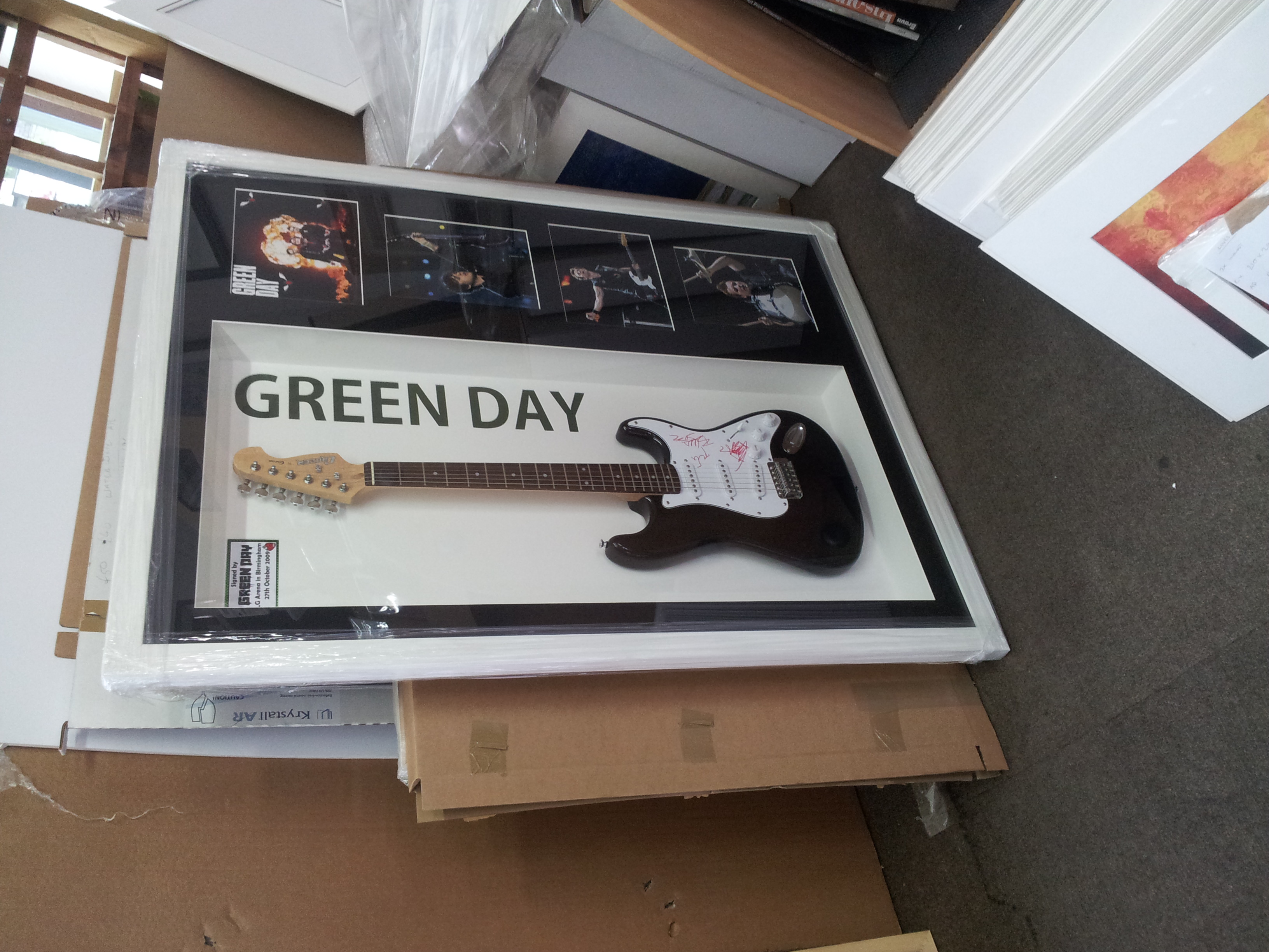

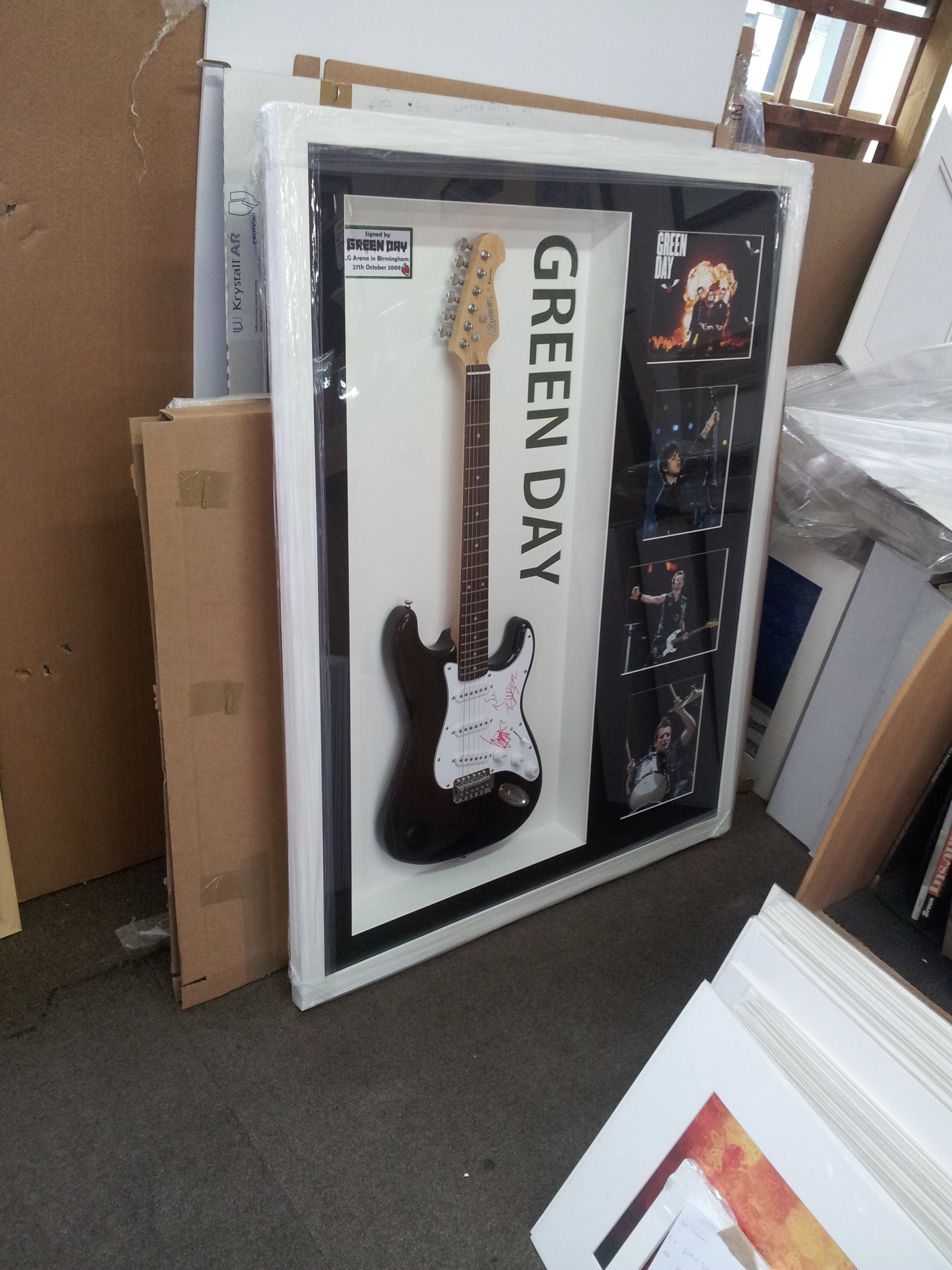

thought I'd post it just because, a bit disappointed the customer couldn't play it so just wanted it sealed.
Re: Gig Stick
Is that a coved mount? Looks the biz anyway
How did you mount it?
I rotated it ... so however you mounted it, this proves it holds both ways

Re: Gig Stick
this job had very little input from me, and was mainly completed while I was Christmas shopping
We degordyfied it somewhat, from the picture the customer brought in, i would have idealy made the mount a little bigger but it is 48 x 36" as it is and the customer needed it quickly, was picked up today, and was very happy.
it's held in with 4 large screws and a stainless steel plate, that also hold the guitar together. I have used this method before, and know it holds firmly both ways.
yes that is a cove box, lots of PVA, hot glue and strengthening pieces underneath, it's quite a heavy guitar.
Jamie who framed it started with us 5 years ago at the tender age of 17, I think he's doing pretty good.
