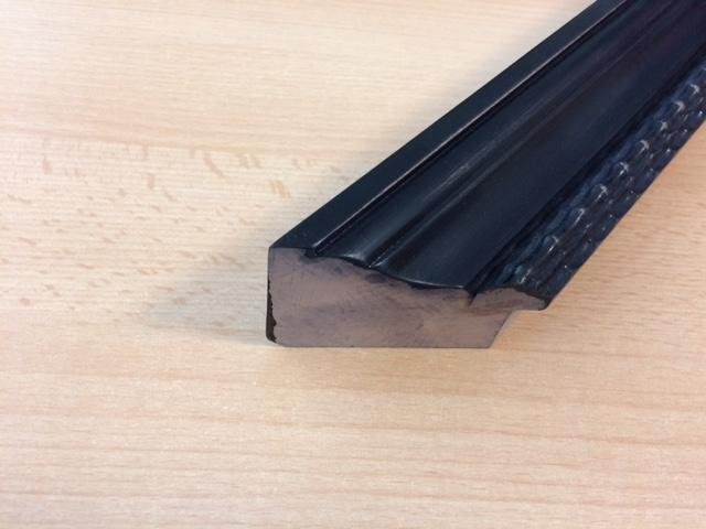

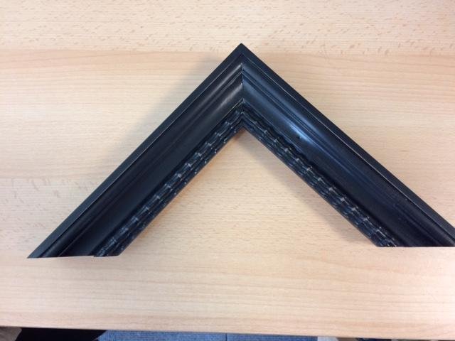

- Posts: 363
- Location: mid wales
Re: Dutch ripple moulding.... HELP !!
I have been playing about with this machine and have produced a sample corner of a basic reverse moulding
hard to get to grips with but it's still developing
I will probably end up supplying them in frames only as there is a lot of machining to supply in lengths
I should be moving onto the wave style pattern soon
- Posts: 363
The timber is Swiss Pear
it machines beautifully and takes the ebonised finish very well
