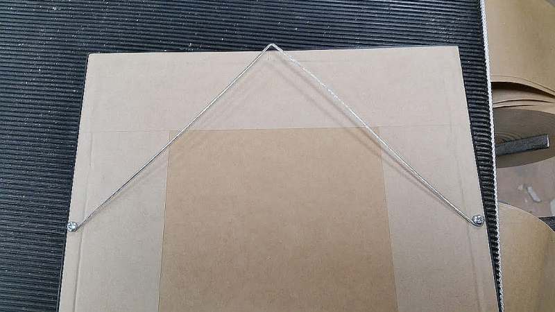

Proof Of Concept
Posted: Tue 22 Jan, 2019 10:39 am
by JohnMcafee
Thought I'd give it a go and test this idea for myself.
10mm pan head screw, pilot hole 7mm deep, plastic coated picture wire, A4 frame.
I thought this would look cheap and ugly, however it looks OK, kind of neat
No visible wire twisting or knots.
Load Testing
This shows the frame supporting 3 paper covered concrete blocks which we use in the
workshop whenever stuff needs to be weighed down. They are 6.5 Kg each.
Total test weight 19.5Kg or 43lbs. Maybe one day I'll test to failure, but my guess the
frame will easily support twice this weight.
Post Test
This test was just to satisfy my own curiosity but I thought I'd share it with everyone. I think it shows that while it has its limitations, the DITH idea is not completely crazy.
In conclusion: Will I be using DITH? Probably not, it is too time consuming. However I'd be queueing up to buy a (cheap) hand tool that would automate the job.
Re: D.I.T.H.
Posted: Tue 22 Jan, 2019 11:58 am
by JFeig
John,
Interesting test.
I have a few engineering questions with your test.
  • - What is the gauge of the wire?
    - What is the size and length of the screw? 10mm long?
    - What type of wood was used in the frame?
    - What is the profile size of the frame moulding?
    - What was the angle of the wire in relation to the sides?
    - How deep was the wire inserted into the molding?
    - What amount of torque was placed on the compression of the twist of wire between the screw moulding?

Re: D.I.T.H.
Posted: Tue 22 Jan, 2019 4:03 pm
by JohnMcafee
Jfeg
I am assuming that yours is a genuine quest for enlightenment and not a prelude to some sort of passive-aggressive down the line gotcha. I assure you that no trickery was involved and I have reported my genuine findings without any exaggeration. Like I said, my conclusion is that I’ll probably never use this method, but it is interesting and, as I think my experiment shows, does not deserve to be dismissed out of hand
You must not have understood the significance of “A4 frame” in the caption of the first image. It refers to the frame size. And with that knowledge I think with that anyone with an engineering bent, such as yourself, should be able to work out the scale of the photos and deduce the answers to some of your questions.
But, regarding the questions with answers that you might not be able to deduce:
Gauge of wire
Maybe you could look that up on the manufacturer’s site, however the diameter appears to be a bit over 1mm, maybe 1.2 – 1.5mm. Note that my demo appears to demonstrate a huge safety margin in the manufacturer’s 25LBS max claim
Wood
Sorry, don’t know the type of wood, it is hard though, like I said it should be in my earlier post. The profile is 12mm high and 9mm wide at the base.
How deep is the wire inserted
Are you really asking if the wire was inserted deeper than the pilot hole?
Amount of torque
Really Jerome? How do you want it, lbf ft or Nm? Either way I don’t have a clue.
However: the screws were tightened just the same as any other, such as when screwing in a D-ring.
