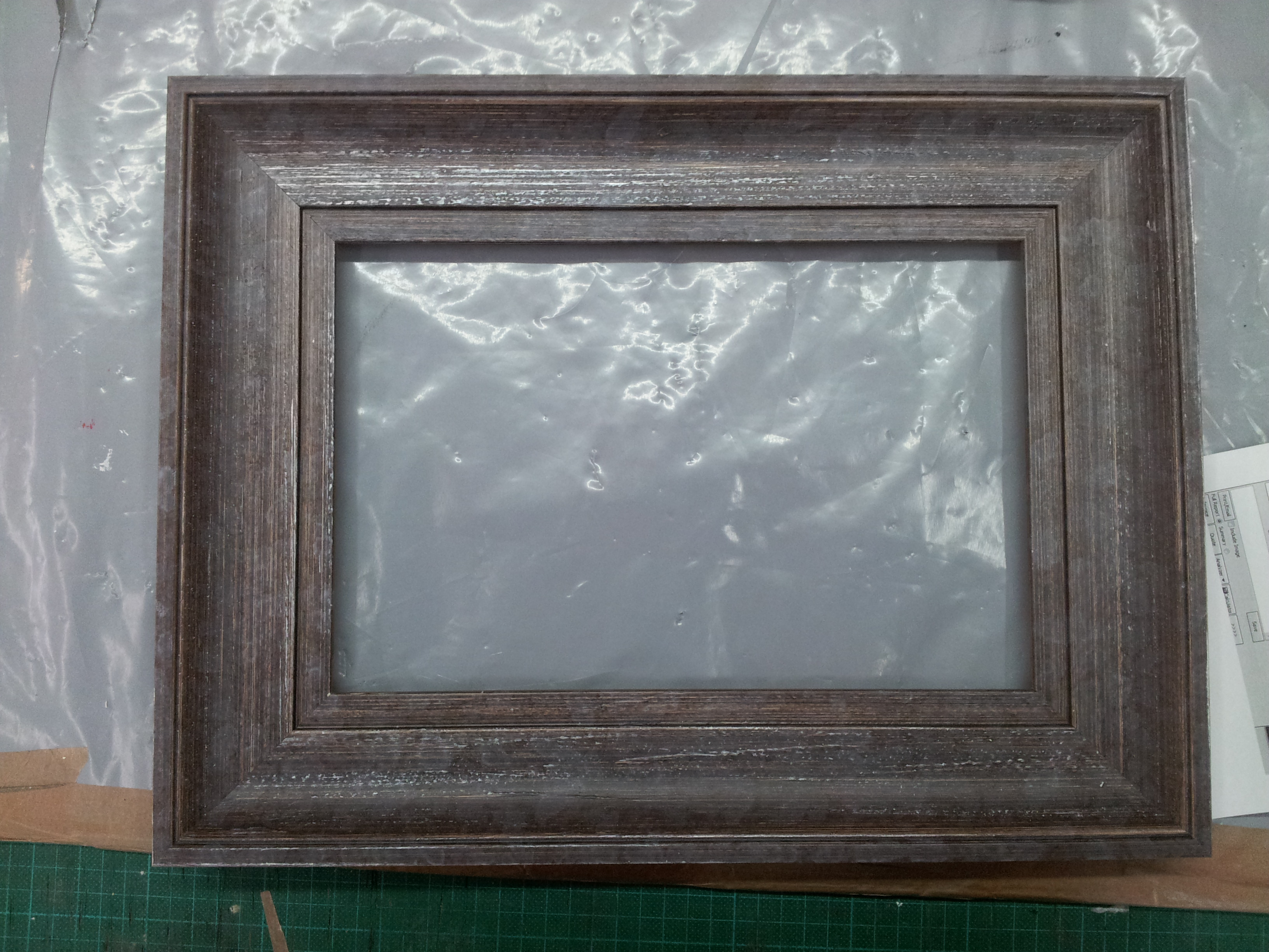

ok 90 odd frames made and decided to try cutting this frame, we usually wait until fresh blades are on before cutting this stuff as the back edge is usually a right bugger.

Re: new blades
Now over 200 frames in and still feel very sharp, no chips on the blades and still perfect corners.
This was the point we swapped the brand new morso blades, but if memory serves me, we cut more hard woods and tough ornate mouldings with that set of blades, the majority of what we have cut with theses has been softwood, still they are doing better than expected.

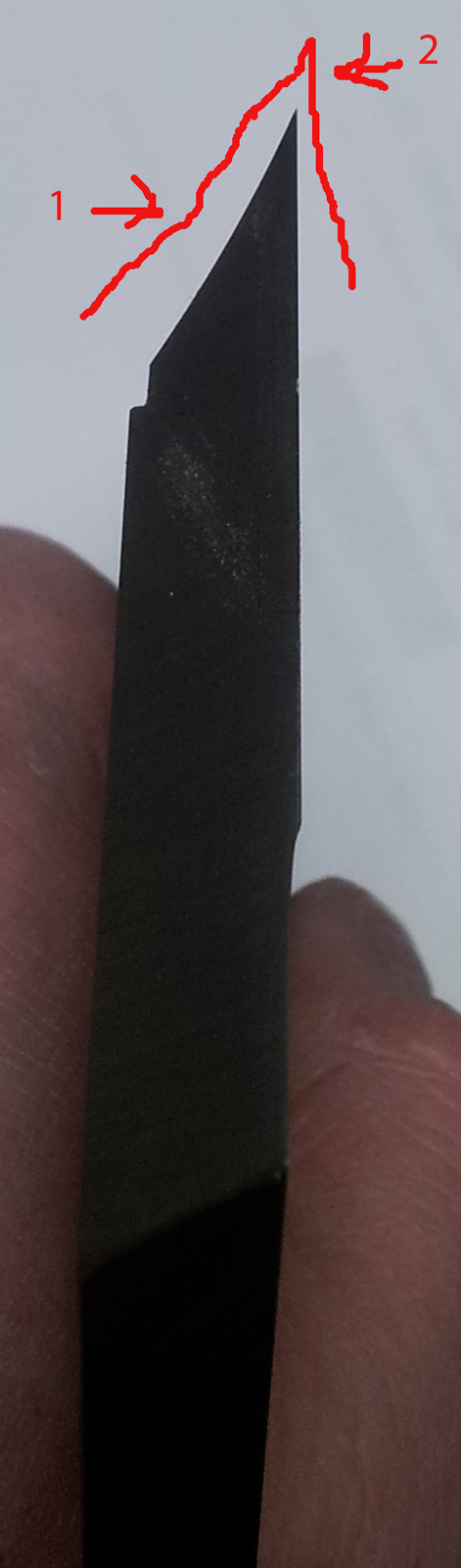

Re: new blades
Ok, the morso blades I just put on just don't feel very good compaired to the framers corner blades, it actually feels like the blades are smashing the moulding rather than cutting, although they are cutting and the corners are good, I am having to put more effort in. I felt so shocked at the difference that I took them back off and have done a side by side comparison to see why the framers corner blades cut so much better.
The picture with the crude red lines on are the framers corner blades,
1. The back of the blade is concave v's a flat profile on the Morso
2. There is quite a difference on the cutting angle the framers corner blade being more acute.
I don't yet know what this will mean for sharpening or how they will perform when sharpened.
