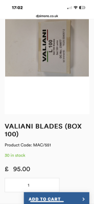

Thanks , had a look but concerned the screw fixing hole is not in correct position for keencut ?

They aren’t fixed with a screw in a hole! They’re held in with pressure, you couldn’t adjust depth of cut otherwise.
I can’t find the ones I used, maybe they’re discontinued - you could try these unbranded ones.
https://www.fruugo.co.uk/100-pcs-replac ... gJ79fD_BwE
The trapezoid ones are less important, you can buy those from toolstation or amazon etc, for a fraction of the price.
Check different framing suppliers too if it’s just Lion you’ve looked at. Simon’s will be cheaper, mainline too I think.
