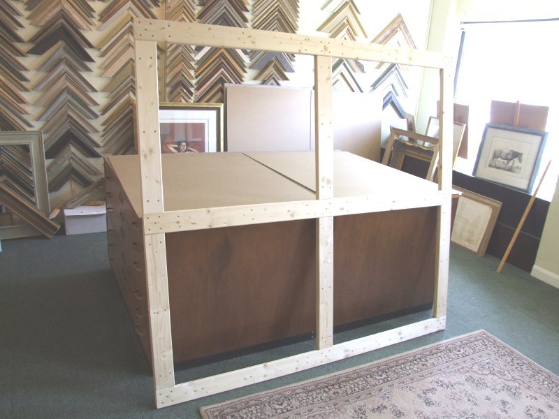

It's wouldn't be too difficult to get a timber supplier the mill you up a simple flat section to whatever size you need.
Then make a subframe too fix the painting to. Once done, all you have to do is fix the Oak section to the edge of the subframe.
It going to be a big beast so using a subframe constructed like the one below is the best option for max strength and min weight. :clap:
