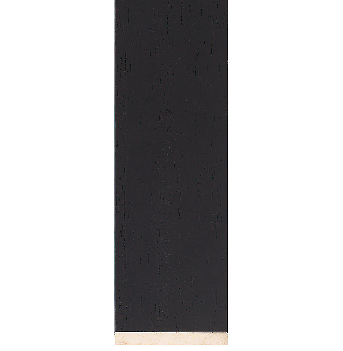

this is what I call a fillet....
What I call a slip is flat on top.

The image Prospero has posted I call a mount slip.

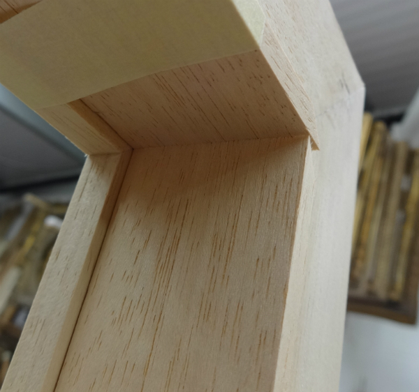

By fillet (which I usually call a spacer) I thought the OP meant this:
- 496_000_167.jpg (135.61 KiB) Viewed 8442 times

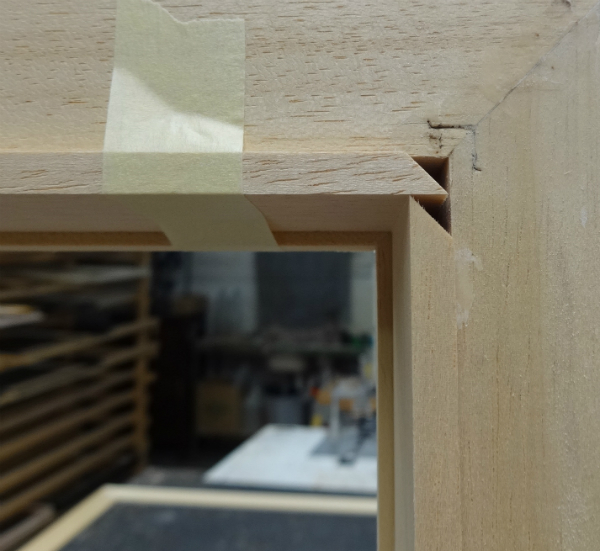

This is what I was trying to explain. Not the best example as glazing is not used and this spacer was glued in place, but anyway.
I don't like underpinning spacers, I tried it once and found they bowed a little which meant that you still needed some DS tape and PVA to hold the spacer flush with the rebate so you could assemble the frame package, but maybe this was just me!
- spacer.jpg (231.33 KiB) Viewed 8355 times
