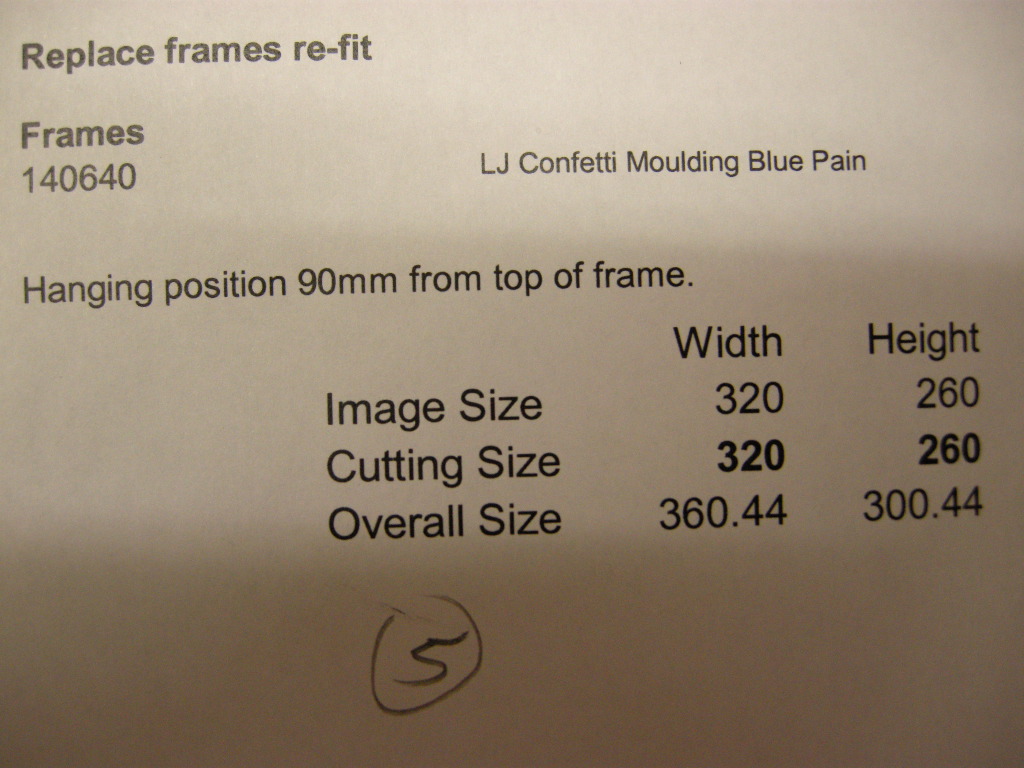

Re: Best way to cut Confetti mouldings ?
I've just taken an order for a confetti moulding - Framiac describes it well!
- blue paint 002.JPG (184.87 KiB) Viewed 9177 times
