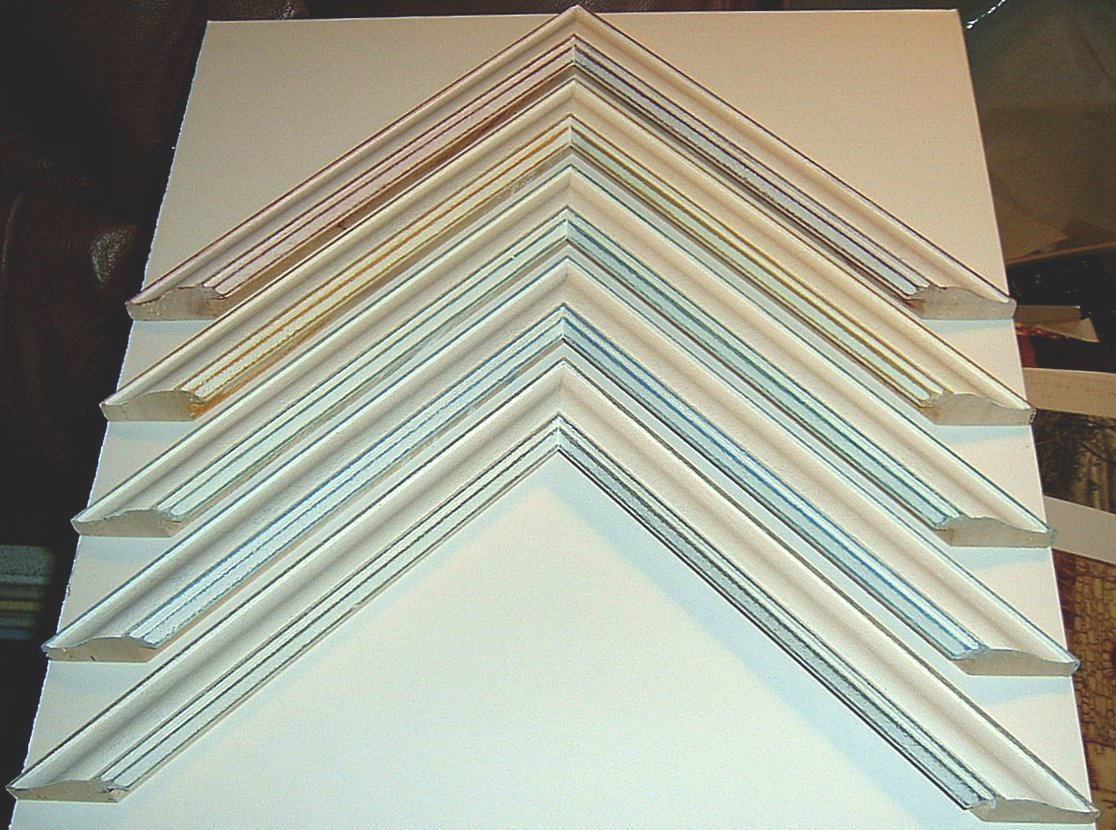

Here's a few more I am currently experimenting with. There will probably be quite a few more using this particular moulding as I have quite a lot of different ideas that I want to try with this moulding.
Simons M99B coloured edges.jpg (213.1 KiB) Viewed 25286 times
The top coat colour on all of these examples is antique white and the base colours from top to bottom in the picture are as follows:
1. Mars red with warm grey.
2. Gold ochre with warm grey.
3. Olive green with neutral grey.
4. Greyish blue.
5. Raw umber.
Comments and discussion are welcome.

what wood type are those mouldings mark?
Posts: 11019
Re: Pictures requested by Featurepiece
The examples in the first picture are pine. This particular moulding is an excellent quality of pine, but at a good price. Most lengths are knot free.
The examples in the second picture are in obeche. Again this particular moulding is very good quality.
I've never had a problems with either of these mouldings. Consistently good quality mouldings at good prices are not easy to find, but so far these ones have been O.K.
