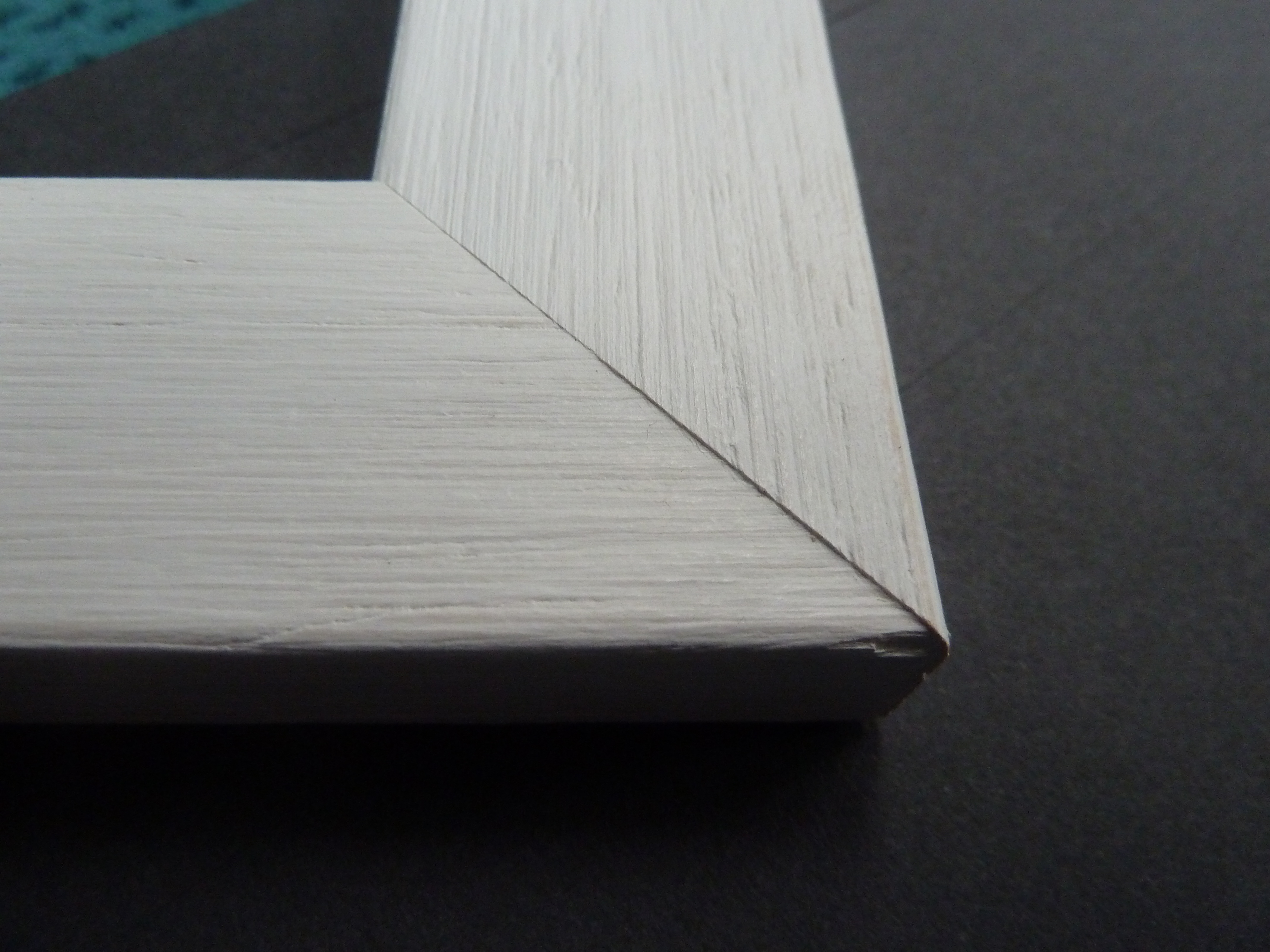

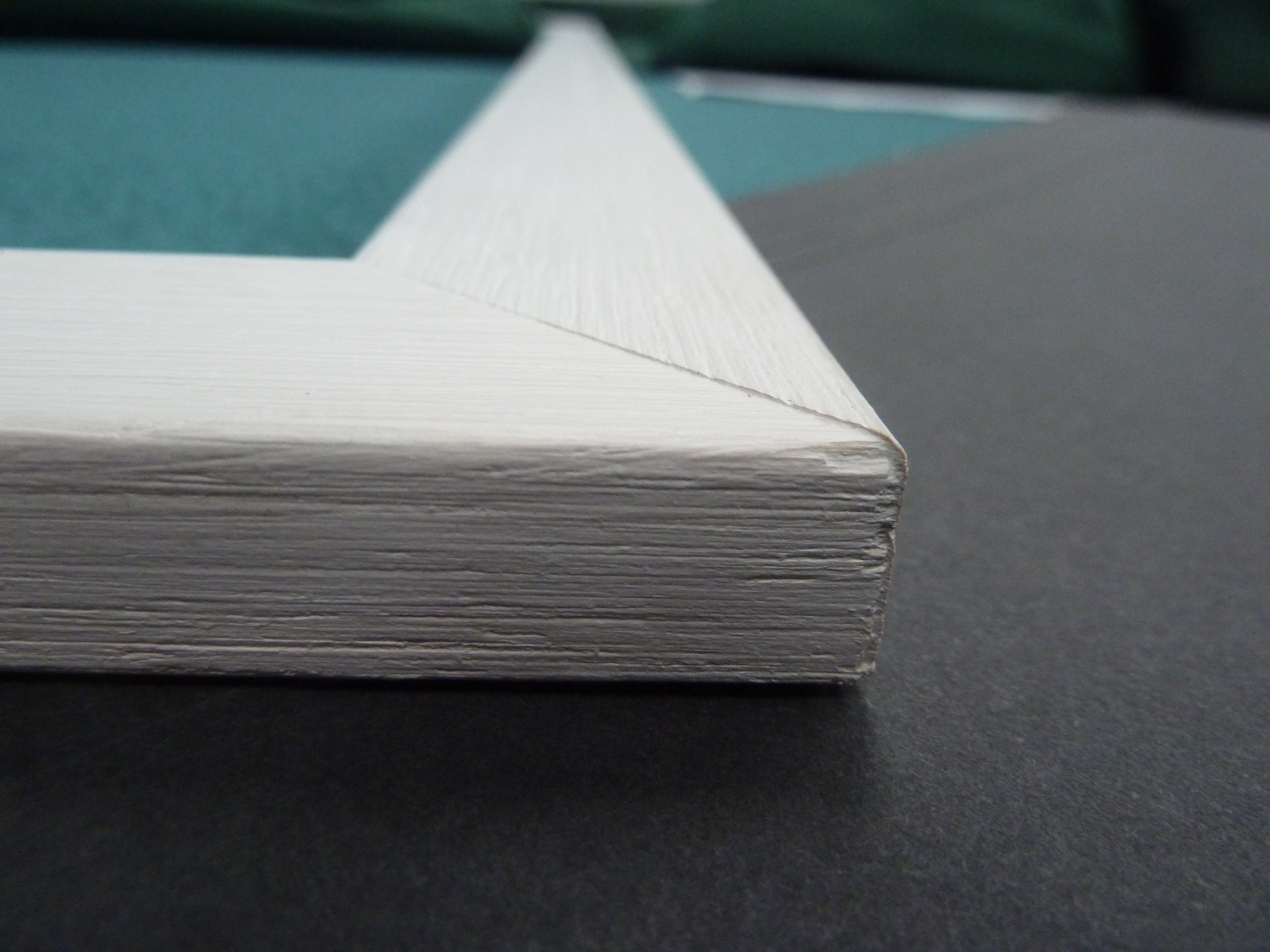

Here are the pics. I added some liming wax to one corner but it still looks awful!

Re: Morso Blades
Hmmmm.... seen worse.
Try a bit of polyfilla with a bit of wax on top when it's dry.
Actually, as long as you have no bare wood showing, that driftwoody texture is quite forgiving when it comes to minor chips.

Re: Morso Blades
You sound like my other half - the solution to everything is filler!
The problem is that I look a things as closely at the photo!
I just think I will spend ages trying to repair and make good and it will still not look good enough. It is an important new customer and it would be better to do a perfect job with better materials and give myself the best opportunity for repeat business - work will be displayed in a shop!
