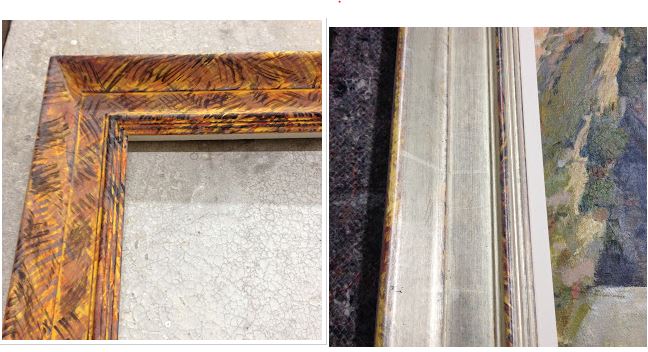

Re: Bole - gold combo
I recently used a greyish White Bole under standard 22/23ct gold. (See photo)I had seen something similar on a very old decorative Italian piece. I don't think it is very successful, (partly due to the moulding)and wish there had been a way of visualising first... There's always photoshop, but.
- image.jpeg (2.06 MiB) Viewed 10634 times
