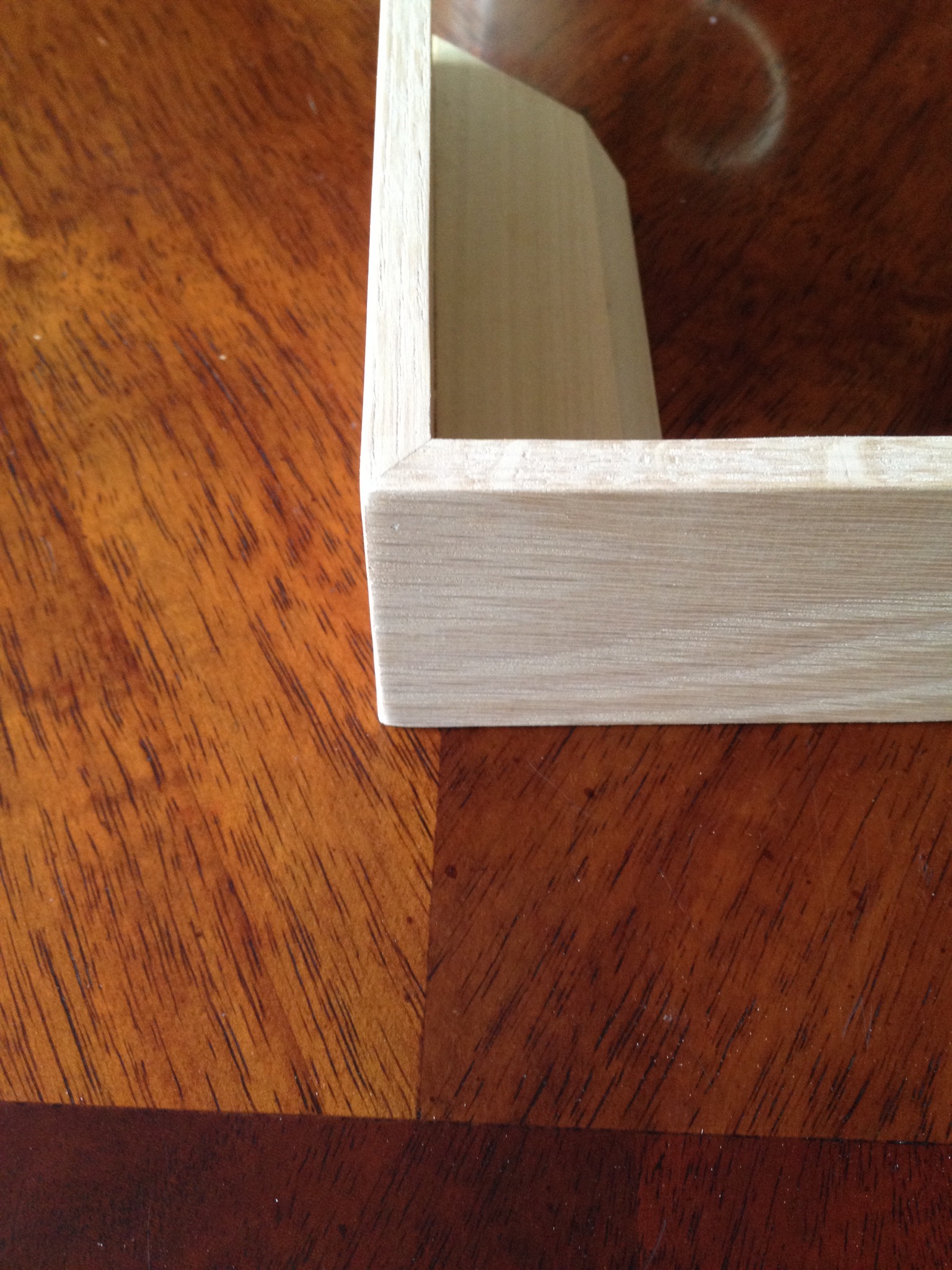

Here is a test piece, for clarification. Is 8mm x50mm oak joined to a tulip base ( it's a subframe profile), glued with a single pin near the top which you can just see in the photograph. The subframe is glued and pinned into place. So far it seems pretty strong. I'm going to make a full frame over the weekend...
Alan Huntley
Ashcraft Framing
Posts: 11623
Re: Joining narrow oak
Nice job. :D
Had to look very hard to spot the pin hole. :lol:

Not your average framer wrote: Glueing the oak to pre-paint wood won't add much strength to the structure of the oak, because it sounds like he is glueing the oak to the paint.
Whilst I agree, does it matter much as the oak is only a bit of decorative trim? You could use masking tape to keep the outer 7mm free of paint to ensure a wood-wood bond.

That's good point about the glue/paint bond. I'll watch out for that.
