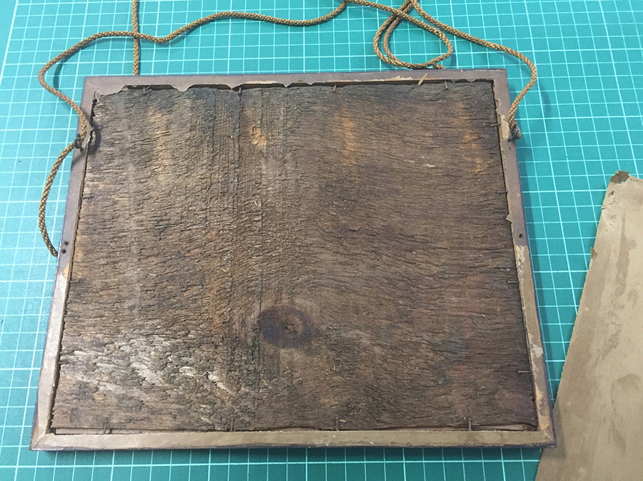

A customer dropped in an old frame to have the picture (circa 1940's) copied. On removing the backing paper I found this; a little acidic I think.

We used to see this all the time, sometimes damage was done, others not, surprisingly.
Getting less common now though.

Don't chuck that old back out! Slice it up into strips and glue it to some square timber.
You have the makings of an awesome 'rustic' frame. Bit of wax and a yellow duster - bingo.
I always save old backs like that. Not often you see one all one piece. That sort of texture
is not easy to reproduce. Pure wood porn.
I've got a few bundles of fence slats in the shed waiting to be re-purposed.

I wouldn't be inclined to throw that backing board away. Those in the antique trade call it split pine backing and was used extensively in early picture frames. As it's just a piece of pine, I'm not sure if it would have any detrimental effect on the frame contents. Either way it would be best to re-use it inside the frame, with a barrier board between the artwork, and this would preserve the integrity of the picture.

Hard to think that composite wooden boards are a comparatively recent innovation.

The customer, against my advice, insisted I put it back as it was. Sentimental attachment won over good practice; surprisingly there was no apparent damage to the picture other than some slight fading.

Actually, it's not the old boards that are nasty as such. It's usually the board underneath that deteriorates.
On old pictures where a print is mounted to cardboard and there is a gap in the backing board(s), the exposure
to air though the gap makes the underboard go mental. So much so that a big brown streak will appear which
very often permeates right though the print. The parts covered by the slats is more-or-less fine.
The slats will go dark on the outside but on the other side they will look as good as new.

Course you can put it back on, just use a good barrier board between it and the artwork, done it many time
