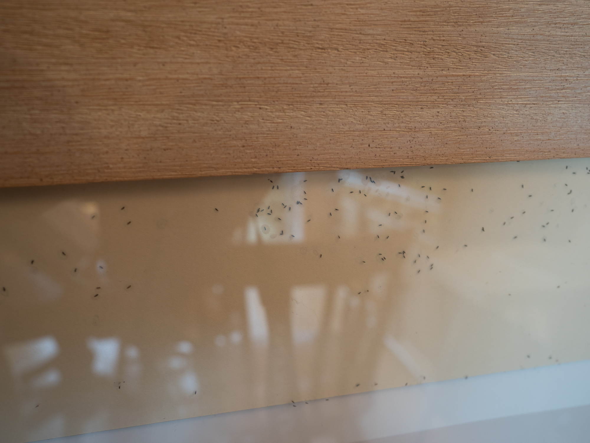

I got a call from a lady who asked if I could clean a 'few' thunder bugs out of a framed picture
The back revealed the cause of the problem
Someone had tried to repair it
The back board was in two halves joined by tape. Pulling it up revealed no undermount so the picture was sitting on MDF.
The picture was taped in with what looks like yellow insulating tape.
She purchased this already framed from a reputable gallery in my local town
Needless to say it will be bit better when she gets it back!

Wow, I've never seen that many thunder flies in a frame before :shock: Will you be sealing up the glass/undermount package before reassembling the frame?

I've seen similar, where people have lathered layer upon layer of packaging/duck tape on the back
in a vain attempt to keep the critters out. Alas! Little do they know. The flies go in the front. They
never go in from the back. :lol: :shock:

The flies go in the front. They never go in from the back
I think in this case the back door was so wide open they just walked in en mass

Thunder flies or thrips do get in from the front of the frame so unless you seal up the glass package they will most likely get in again :( If you haven't used this method before here is a video showing how it is done https://www.youtube.com/watch?v=fk30bmLwQ2o Just use the P-90 tape no need for the foil method.

Thanks. I have done that before and was planning to do it on this one. I will look at the video though to check I have been doing it right :D

I haven't seen the aluminium method previously. This picture is too big for that method but I will definitely seal it with tape
