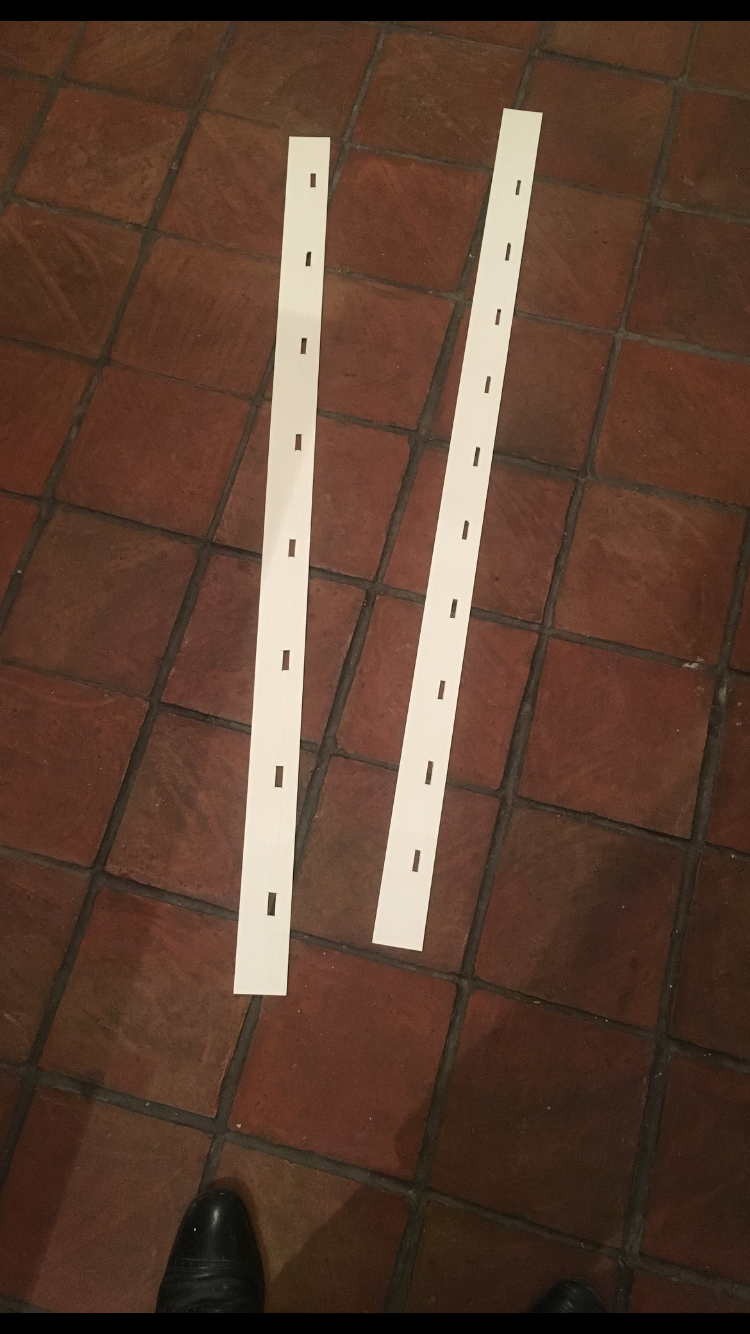

A quick way of cutting the slots on mountboard is to use a pair of sharp wood chisels and hammer.
Use a wider chisel than the tape for the two width cuts and a small chisel to cut out the sides. On a makeshift anvil of wood block and scrap mountboard, one whack per cut with the hammer should be enough.

Well I do like your chisel trick. Thanks, Dermot. I like it even more with the way I've previously tried doing it, which is to use the mount cutter to cut the long edges of the hole and the chisel the short. Thanks to the ruler on the Mount Cutter, you can get them regularly spaced and absolutely in line (though I'm sure yours are absolutely in line anyway) . It also means the edges are neater. Moreover if the bevels go in the right direction then it allows your hinges to flow in the right direction.
Still think you should be using a backning board between the mount board and the MDF though...
