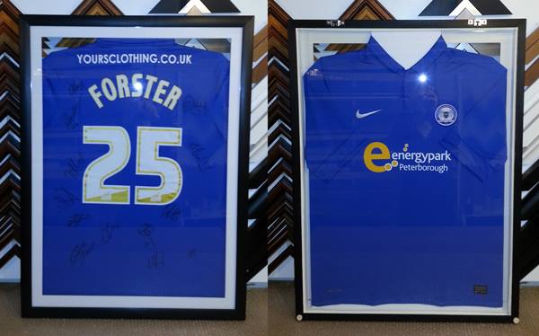

Re: Double sided Football Shirt Frame
I do it and offer it at £190.00. It's about the same work as single sided. Floating in the middle, not sandwiched.
Hi Peter, I've done them a few ways, it's pretty easy to see from the photos what I've done.
Slots cut into the spacers for the formboard to slip into.
I either seal the back glass in place with silicon or just use framers points and tape over. I do use black tape now not the brown tape.
I've done without mounts too with AR glass which looks pretty cool.
Hi Framie, Thank you so much for that, more help than you realize
I've never thought of slots in the spacers for the foamboard in fact, I've never seen that method before either on youtube or in a book
can't wait to try it. I can see shirts could be done single sided as well as d/sided using your method - single/double/triple mounts no problem - just extend the foamboard former accordingly. Who say's you can't teach an old dog new tricks
You are certainly giving your customers very good value for their money
Thanks again.
Peter
Thanks again.
Peter
