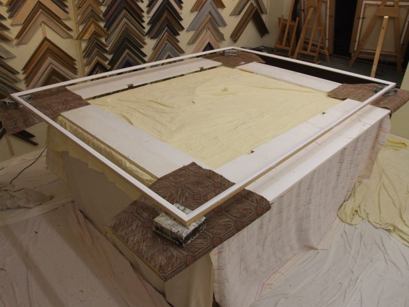

Frame to fit a 7' x 5' 2" canvas. :D
First step: Make the liner. Rose&Hollis A279. I widened the rebate on my routing table. Big canvases need lots of elbow room.
As it turned out, it was a bit out of square and just fiited. I didn't have the painting on the plot, the guy was still working on it
and no room anyway.....
You will see I had to build extensions to the table to accommodate the thing. I had to commandeer the front of the shop as it was
too big for the workshop. I don't usually like doing 'mucky' work in the shop, hence the dust sheets. I did manage to underpin the liner
but added steel 'L plates ' on the corners.
