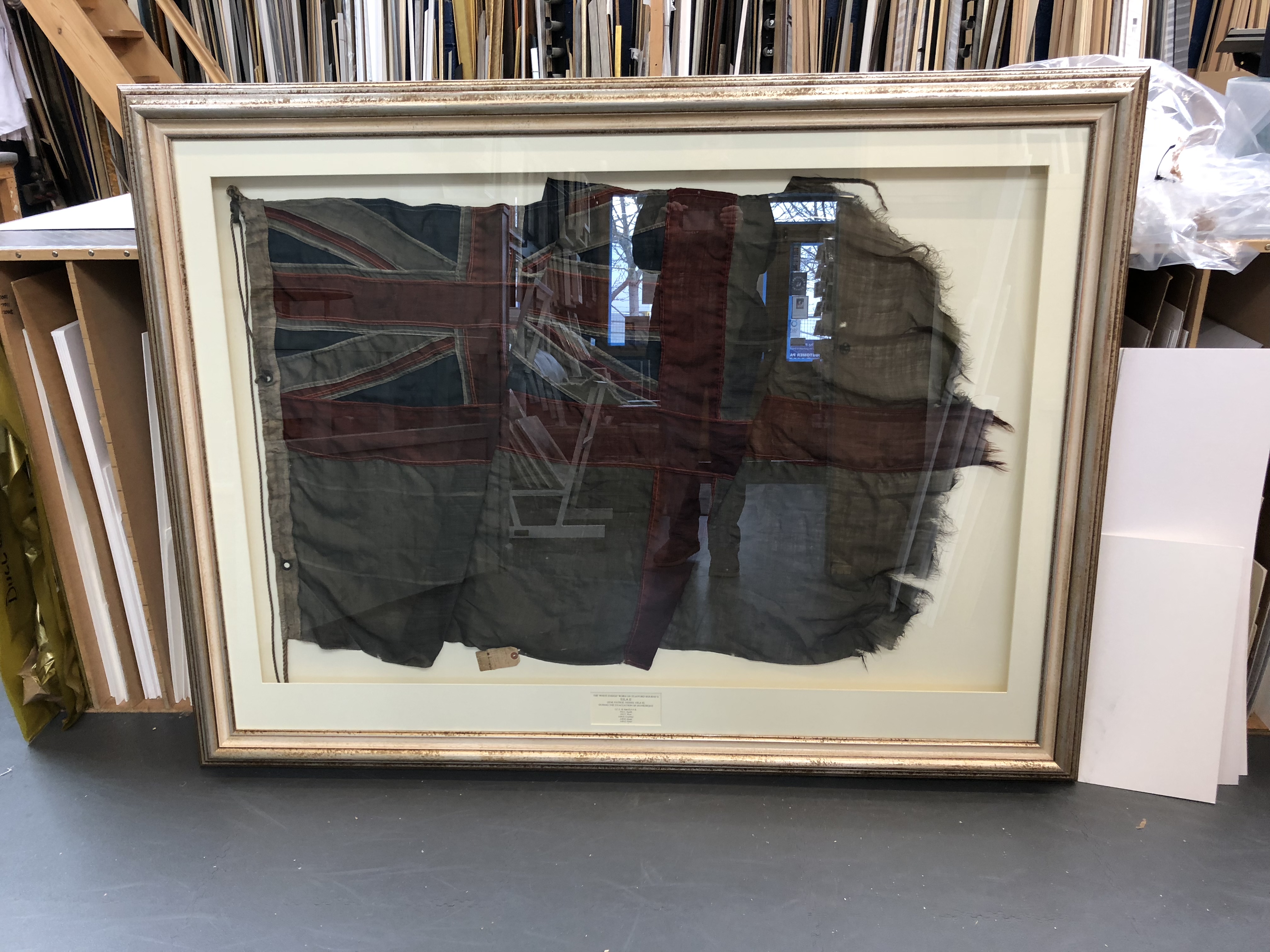

We had a request about 8 years back to frame a White Ensign that had been flown on a Dunkirk Little Boat. The Ensign had belonged to the customer's father and had a long history of eventful travel with him during WW2. In the years after the war the customer remembered it framed up outside his father's company board room and it being, in his words "flat and lifeless". So his request was to give it a bit of life as if it was fluttering in the breeze! The result was as you see below. The flag is covered in soot because it was a coal powered ship and it is very frayed because it was flown so much and often in rough weather. The tag at the bottom was attached to it after the war by his father and lists the names of the crew who took part in the Dunkirk rescue so it had to be left intact.
We used Museum quality boards and the Ensign was sewn to the board using a full sew support method. No other padding or material was added, we kept it simple for this one. This method of overlapping sections has the added benefit of reducing the size slightly which also meets your requirements.
Recently the customer's house was partially damaged by fire and luckily the Ensign was just far enough away from it that only the frame suffered heat and smoke damage. The insurers thought it was ruined because of how sooty it was until it was explained it was meant to look like that. We had it returned to us for a clean up and reframe and the inners were still perfectly sound and it only needed a quick clean up of the edges of the mountboard before being put into a new frame.

What a superb example of professional framing and meeting a customer's requirements and expectations :clap: :clap: :clap:

Excellent job, that’s how my customer described he wanted his but it just didn’t look right folding it here and there. I think the distressed nature of yours helps quite a lot with the overall appearance of the finished job. Will show him yours and have another go at trying to billow layout that looks reasonably natural.

Here’s another angle. The reflection from the glass does make it a bit awkward to see, but you’ll get the general idea. :D

Nice job Jo

Fantastic Work Jo :clap:
What glass did you use?

Thanks for the lovely comments. It remains one of my favourite pieces of work. It was one of those jobs we didn’t want to hand back, a true bit of history and we were so glad it survived the fire.
The glass was standard 3mm - apart from the size of it there were a variety of reasons for that including where it was being hung and the UV filtering already in place in that part of the house.
