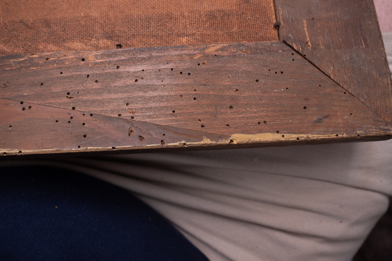

Re: Old frame with woodworm - advice?
The woodworm holes!

More holes.

Just treat the wood-worm with a can of something off the shelf.

In the woodworking realm there are epoxy products that are applied to wood to strengthen and fill in cracks and holes.

I wouldn't worry too much about the worm holes. People get panicky when they see them but the don't appreciate
that they are exit holes not entrance holes. The danger is if there are larvae munching away inside, which I doubt.
You could seal it up for a couple of years and see if there is any dust/beetles inside the bag. long-winded exercise.
Treating it with chemicals would prevent re-infestation, but unlikely to kill off and live larvae still active.
I have heard that the only sure way to do it is to put it in a freezer for a few months. Know any butchers?
