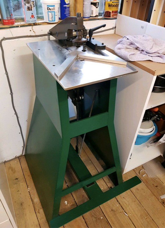

Thanks for the responses and warm welcome. I did an aircraft technician apprenticeship many years ago so I will be able to 'adjust' and 'modify' as we get to know each other.
I paid £250 which seemed like a good price, the machine itself looks in little-used condition. I wonder why :lol:
I won't be running a framing business but the difference between the raw materials and the local framing prices, I will only need to frame 8 pictures before I have made my investment back.
Get ready for my possibly dumb questions :D
Posts: 11005
Re: Hello
Looking at the picture it looks like it's in pretty good condition. I hope it works out well for you.
