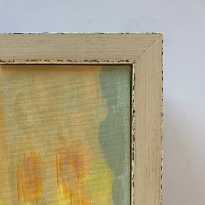

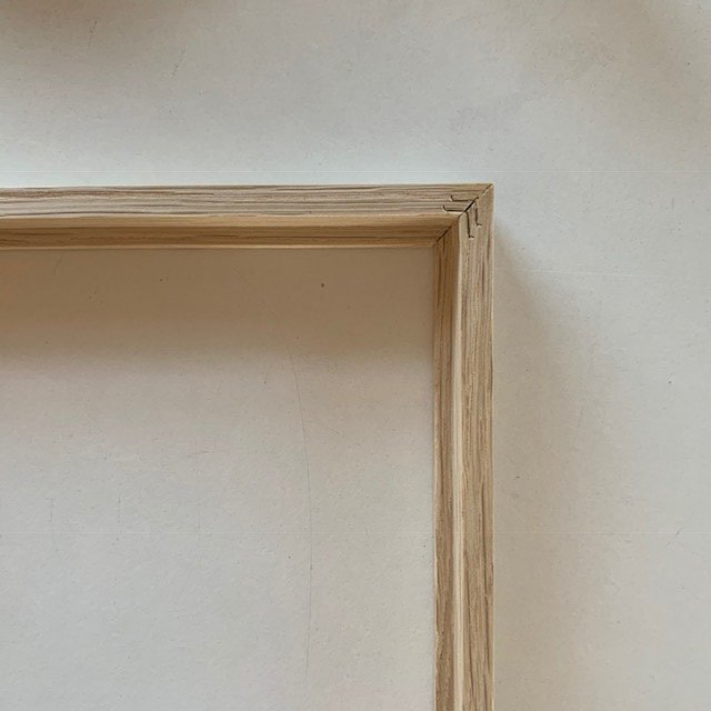

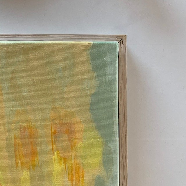

Long story short, I wanted to create a tray frame from a standard rebated moulding. I'm thinking to call it the triple - banger method:
Re: Tray frame from standard rebated moulding
Yes, that works quite nicely and it's somewhat different too! There's a lot to be said for doing things that are a bit different. I think the ability to produce things that are a bit different can be very helpful from a marketing perspective and there's no shortage of people who have a thing for things that look a bit different, and special.
The finished colouring looks pretty good too! Nice job and nicely executed as well.

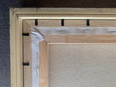

Hey Mark,
That's interesting.
How is the canvas held in the Oak frame, as it looks like it would fall out of the top frame without fixings? I can't see any.
Justin
That's interesting.
Justin
Hi Felicity,
I was just wondering what the whole arrangement looked like from the side. Are the front and back mouldings flash at the sides, or is the front moulding proud of the back moulding at the sides. I think that having the back of the tray made of oak, and having the oak on display (so to speak), is a bit of an inspired touch.
To me that's an example of instead of trying to hide the rear moulding, it's on display and you've made it into a special feature, by not doing what everyone else does, but taking the opporunity to show off a nice piece of oak. Also if I am correct, I suspect the the underpinning of the rear moulding, was done from the front to be hidden by the front moulding, so that there is a lot of the underpinning is hidden from view.
Is the front moulding removable and how is the front moulding secured in place? I think that some of the really clever ideas, that you have used in doing this are not immediately obvious to even some other framers and it probably has taken a bit of time for some of us, to identify some of the rather well thought out and inspired thinking behind this approach.
First class thinking and execution! Really well done!
I would be tempted to take in a stage further and loss the remaining underpinning wedges from the back a have as little visible fixings from the rear as possible. not that I would ever want to detract from such an amazing job. Well done, Felicity!
The canvas stretcher is secured the old-school way, by hammering nails through the sides. In the photo below you can just see one little nail sticking up in the airJustintime wrote: Wed 24 Jun, 2020 4:19 pm Sorry Mark, thought it was yours.
@Felicity, how is the canvas secured?

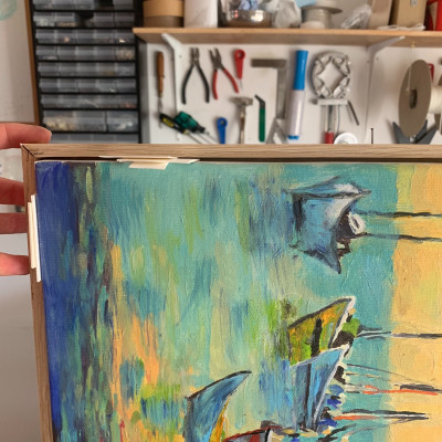

Thanks for your appreciation! Like many framers, I’m often much more interested in the back than the front, guffaw.Not your average framer wrote: Wed 24 Jun, 2020 5:03 pm Hi Felicity,
First class thinking and execution! Really well done!![]()
The front moulding is removable as it is secured just with points. It’s a pretty chunky moulding: the giant 10mm rebate lip helped with making it look tidy from the front, and the depth meant everything including the canvas stretcher was hidden away from view the sides. I appreciate what you’re saying about making the oak construction at the back a feature however in the end I decided to tape the lot so it looks tidy for the customer, and to keep the points secure.
That's great. Very tidy job. I wouldn't tape over the canvas on the back though. It will only damage the canvas in the long run. Imagine if the canvas ever nerds restretching in the future.
