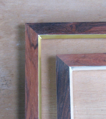

After polishing up the surface, the bevels have now been gilded with both 22ct gold leaf and silver leaf.
As can be seen, no attempt was made to mask out the bevels. This was because the leaf was laid by the process of water-gilding. This is where the bevels were wetted with water and the leaf plonked on top. As the water soaked in, it drew down the leaf onto the gilded surface. And the further advantage being that the excess gild is easily removed by a light sanding.
The beauty of using real gold for this exercise is shown in the following two photographs.
The first photo shows how the gild defines the artwork when seen by looking 'head on'.

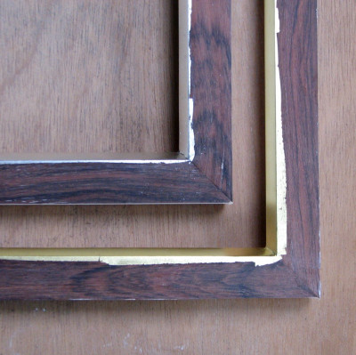

The second shows the moulding when viewed from the side.
Here the gleam of light from the gold will illuminate the image set in the frame.
