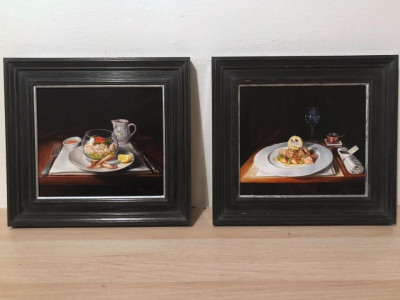

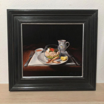

Hello all. I bought some Kolner bole a while ago and gave it a go. 3 coats of red acrylic gesso, light sanding, 2 coats of black acrylic paint, polish with steel wool, mask off inner edge with masking tape and paint with Liquid Leaf. Happy with how they look, very different to the the wax polish look, it has more of an antique feel to it. One of them is much better than the other though, I did a slightly different method with that one but as it was a learning experience, I don't really mind.
Paintings are mine too, I did 12 of these for an exhibition for an Albert Roux restaurant a few years ago. These 2 were the dead ducks that didn't sell and came home again with me.

Re: Trying a new finish
Nice finish.
It is a personal preference, but i prefer liberon gilt cream over varnish particularly for finishing over a colour like black.
The key with hand finishing in my opinion is never stop experimenting. I have just found a new combination which i can post after Christmas day, but it was a complete fluke finding it worked well. That is not the first time i have "fluked" a nice finish. I play with offcuts all the time.
Nice painting too.
Nick
Nice painting too.
Nick
I am confused- does Kolner offer acrylic bole? Frame looks lovely.
Very Nice.
I think I would gild the inner raised reed up to the centre panel but that's just me.
Very classy work! Looks great!

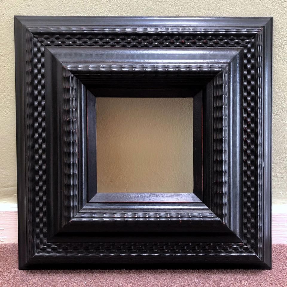

Hello all. Thanks for the comments but this post is from December last year. Not sure why it's popped up again?
Here's a couple of frames I have just finished though. Hope you like them.
Nice tabernacle frame for a vintage print
And a dutch ripple style frame just finished today
Matt
Matt
Matt, these new frames are superb (as are the ones from the old post).
The artwork is incredible as well.
Hand finish is not something I have attempted yet but a question I have is how do you know what combinations of moulding will work when stacked?
Are there any books or common mouldings that people use or is it purely trial and error with offcuts??
Allan
Allan
Hello Allan. Thanks for your comments. I'm fairly new to stacking frames so for me it's a case of looking at mouldings online and guessing which ones go well together then buying lengths in and experimenting.
Of course, the more mouldings I buy the more I can physically hold them together and have a better understanding of how they'll look together. So yes, mostly trial and error for me but learning as I go.
Hope that helps
Matt
Hope that helps
Matt
It took a bit of hard work getting it though! I also notice how well the embossed pattern on the dutch style frame lines up so well at the corner joints. What a nice job! Loved it!
I think I must have a go at that moulding some time!
I very much enjoy making stacked moulding frames and I produce the individual frames to be a really close fit. After joining each inner frame the wedges expand the frame ever so slightly and I end up sanding down the swelling at the corners, which results from underpinning them. It's only aboult half a millimeter, but I'm looking for a perfect fit.
I do this with my bench top belt sander and it takes just seconds to do. The inner frame slides into the outer frame on a film of glue and I fire some pins in place with my headless pneumatic pinner and these headless pins also act as clamps while the glue dries. I use various power tools to help me cheat a little and to beat the restriction that I have been left with following my stroke.
My other favorite power tool is my bench top band saw. Many tabernacle style frames have feature and details which need something other than a Morso to create and many such details are possible with the band saw and minimum effort. I have had such thoughts in mind for quite some time and maybe I will give this a try at some time when I've managed to get everything sorted and up and running.
Hi Matt, like everyone else Love what you are doing. For the latest Dutch Ripple Frame, where do you source the moulding I tend to use R & Hollis but cannot see anything like.
It is not just one moulding, but is the comibnation of one moulding with the addition of a deep sloping slip inside the dutch style moulding. As far as I can tell the main moulding is Simons 7676//44, or Rose and Hollis A644, both of these mouldings are in fact exactly the same moulding as far as I can tell. it is not particularly easy to be sure exactly which slip moulding is being used in this frame, but Rose and Hollis A218 might be a posibility.
Hello all. Thanks again for the great comments! It's very encouraging after my very short time framing, not even a year yet.
The ripple frame is a modified R&H A644 with a beveled slip also from R&H.
I like the A644 moulding a lot but I thought the outside edge was a bit dull so I added a further piece of moulding to make it slope down to the edge of the frame rather than keep the slightly blunt edge it origianlly has. To make this look right I had to slice off about 4 mm of the bottom of the A644 so it didn't stand too proud from the new outside moulding.
Here you can see the difference between the moulding as it came and my frame.
This was quite a tricky project as all I have to cut the moulding is a Nobex Proman hand saw and that A644 is pretty thick!
Regards
Matt
Regards
Matt
