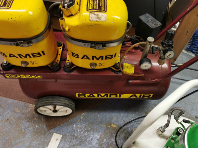

My Bambi Compressor died yesterday, luckily I found one local on ebay to get me by for now. It's old, seems to work fine, the only problem is I have no idea how to attach my underpinner. My existing one just has the standard quick connector on it. Am I right in thinking I need some kind of adapter to fit a quick connector on the right. Not sure if it is supposed to be attached on the connector on the right or if I am looking in the wrong place. I have attached a few pictures.
Any help will be much appreciated.

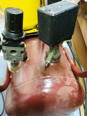

The one on the right is a safety valve. It’s the one in the left you need a connector to, the one with the bowl under it.
It looks like 1/4” BSP so you need a 1/4” male PCL fitting (could be 3/8 or 1/2 though)
I’m referring to your second picture by the way.

In your first picture the valve on the left gives you the pressure in the tank. The valve on the right can be adjusted to the output pressure you need. That’s where you need your connection.

What Abacus just said.
If you are lucky you should be able to remove the connectors from your dead compressor and fit them to the replacement. I tend to wrap PTFE tape on the threads to help with sealing the joints.

Thank you all for your help, I managed to get the other connector off my old machine and swap them over so I can get working again. All seems to be working fine, it looks ancient (1991) but hopefully I can repair the leak on my old bambi and this will just get me by in the meantime and then I can keep as a spare.
