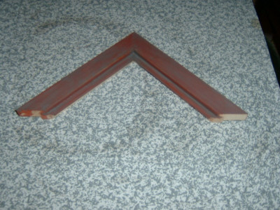

Two pine mouldings stacked and hand finished.
Here's another photo. The mouldings are Simons 0PINE/0028 and Rose and Hollis A10 (pine).
I've only recently bought the Rose and Hollis moulding and today was my first time to use this moulding, I had only just put some glue between the two mouldings and the phone rang. By the time that I got back to the two mouldings thad glue had set, so I did not get the chance to pin them together as tightly as I planed. The finish is oxide red base coat, with a grey wash and this moulding combination is a quite usefully affordable combination.
I want to try a few more colour and wash combinations, as well.
Re: Two pine mouldings stacked and hand finished.
Not every moulding and hand finishing combination which I try always gets to see the light of day in my shop, but this is one which I think is set to go further. I really like the combination of the red and the grey and I can see other colours working equally well with the grey. I am also thinking about trying the same mouldings in white, with a colour accent on the sight edge of the top moulging, which I also think will work quite nicely. The combined cost of the two bare wood mouldings is particularly good value for money to me.
I like the rustic look of this moulding and would be interested to see other colour combinations. I can see that the larger (outer moulding) is flat but is the inner one also flat or slightly cushioned? A wee bit hard to tell from the photo.
The smaller inner moulding is 12mm wide x 12mm deep and in the pine version your will be amazed how cheap it is. The wider outer moulding is usefully cheap too! A much easier finish would be to just do it all in one colour. For me the cost of the materials and producing frames from this combination is a real big deal. There can be a really good price differential between the cost of producing this and the potential selling price. It also has quite attractive and fairly generous proportions, so even with a really helpful mark up it does not seem expensive.
It is helpful to look up images on the internet for furniture of the same colours for the various stain colours in the stain recipes in that book, Many of the stain recipes are using not particularly helpful ingredients, which are not easy to obtain, if at all. I often substitute an equivalent colour ingredient as a acrylic artist paint instead and mix the colours to match furniture colours for internet images. It is necessary to adjust the colours to compensate for the background colours of the wood type being stained. There's no advantage in taking much notice of quantities and ratios in the books recipes at all, just mx the colours by eye. I particularly like the Polyvine acrylic wax finish varnish stain colours, which are not always perfect on every background colour for each and every wood type and this is where you can modify the stain colour with acrylic artist paints to tweek the colours to suit. Much of the time it is better to wait a short while a wipe away any stain colour, which remains of the surface of items being stained, to avoid an unnecessary level of gloss.
Not all woods stain as well as others and sometimes it is necessary to pre treat the wood to prevent patchy stain absorption. This is easily accomplished with a little watered down emulsion paint of a similar colour to the background colour of the unstained wood, which soaks in to areas of the wood, which are normally much too absorbent. The colour of the excess absorbed colour does not show as it is not different from the base colour ofthe wood, but it does block the over absorbent pores of the wood. There is a phenominum known as grain revesal, where some parts of the wood grain absorb excess stain creating an unnatural looking effect, where the stain wood just does not look like real wood when stained pine. I like to use pine mouldings, but it is necessary to learn how to prevent pine from absorbing stain in such a way as too develop an unnatural look, I also like to soften the visual effects of the grain to create the impression that it is a generally better quality of wood type, which results in a more easily saleable item. This is often achieveable by washing the wood first with some well watered down off white emulsion paint before staining the wood.
I don't necessarily wait for the watered down emulsion paint to fully dry, so that alittle of the watered down paint leaks out into the water based stain and creates a slightly misty effect within the applied stain and creates an apparently softer looking woodgrain. Did you notice that the two stacked and hand finished mouldings in the photo are knot free. Not all small pine mouldings are knot free, but some are! it depend manly on where the manufacturer get their wood from. I hope that this is helpful to you!

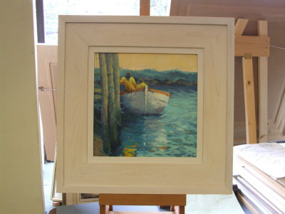

Using three square mouldings is very effective. It's all in the proportionate widths.
This just has a coat of pale shellac and a dragged wash of white ripple paint.
