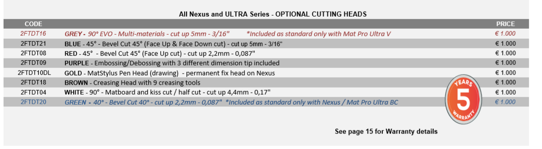

we need some help choosing Valiani Nexus 150 heads.
We mostly cut passepartout, so therefore we need 90 degree, 40 degree and/or 45 degree heads. As we'd like to make custom boxes, then the brown head is also a nice addon.
My main questions are:
1) Do I understand correctly that the 45 degree cut is more difficult than the 40 degree one? Which is more common in everyday use?
2) The difference between blue and red head - does the blue head make same quality cuts when it's meant for thicker materials?
3) Same questions about the 90 degree heads.
According to Valiani all the heads make equally good cuts on different materials. But that does not make sense as the different heads are meant for different thickness.

Let me rephrase the questions:
1) Do I understand correctly that the 45 degree cut is more difficult on thicker materials than the 40 degree one? Which is more common in everyday use?
2) The difference between blue and red head - does the blue head make same quality cuts on thinner materials (1,4 or 1,7 mm mat) when it's meant for thicker materials?

we only have
Green 40 degree for everything
Yellow 90 degree with metal foot , so doesn't wear out
Brown creasing head , good for box making
Purple for debossing mounts
Gold pen head
top 2 we use all the time, day in , day out, the rest not very often,
The blue head ,45 degree, makes your bevels look nice and wide, but never got around to get one, so not missing it

We use grey and blue for most stuff, the extra angle on the blue head makes the mat board look thicker!
