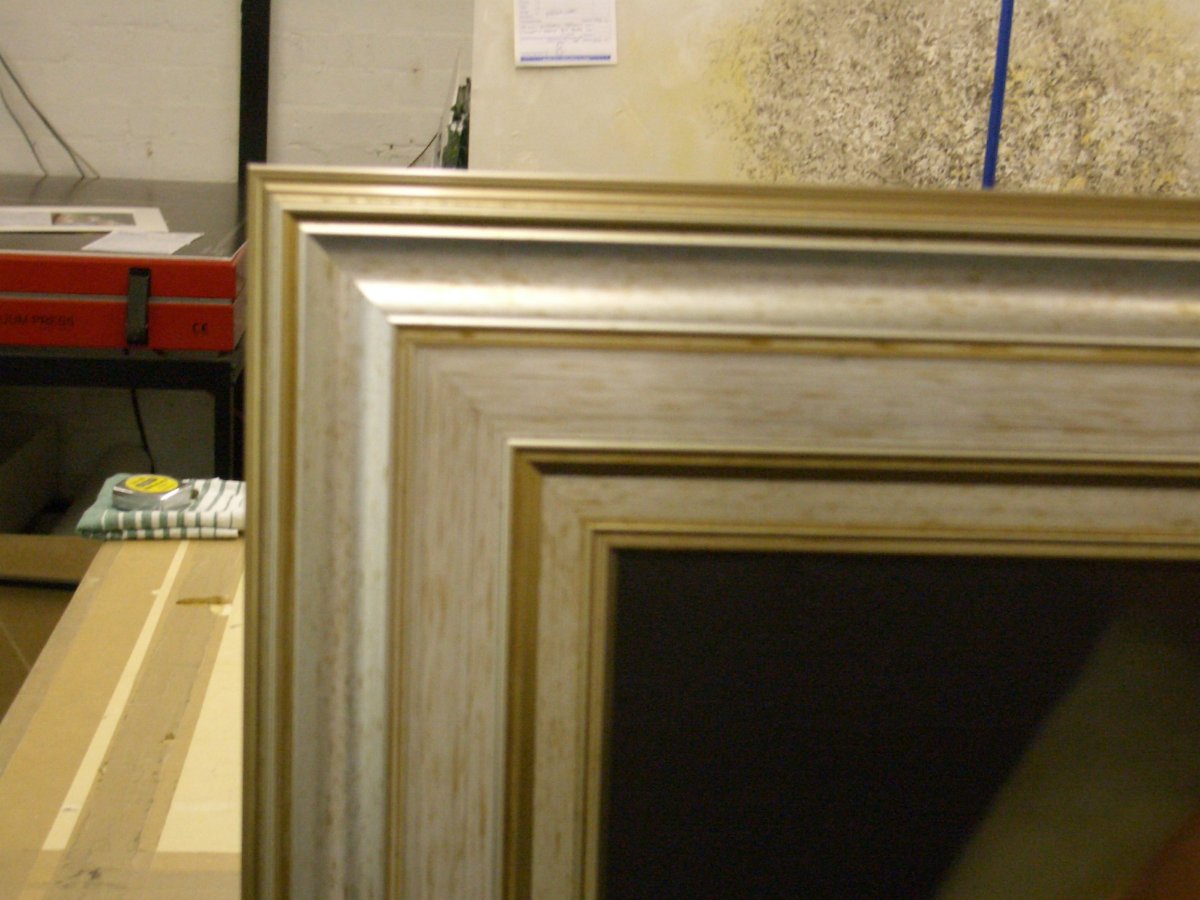

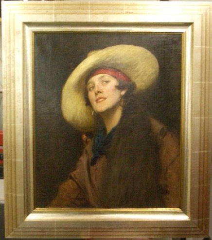

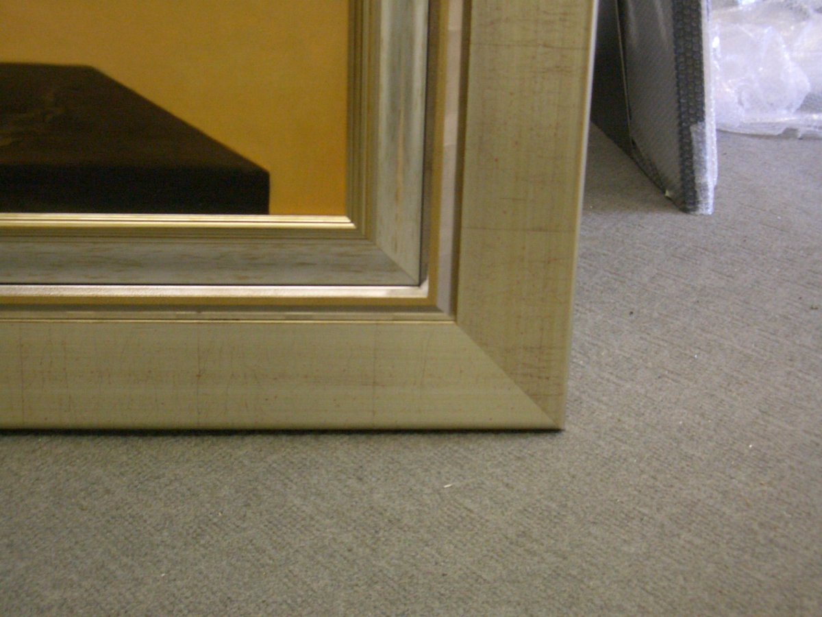

Hi. Thank you so much for all your replies - this has to be one of the most helpful forums around!
I’ve attached a couple of images of the type of thing I’m trying to do.

Right O.K.,
I shall go through these one at a time starting with the top picture in your reply. I am starting from the outside and working inwards!
1. The outer most moulding is Rose & Hollis A194 (obeche)'
2. The middle moulding is a flat moulding, or spacer, possibly Rose and hollis F9 (Obeche), but maybe it's something else like perhaps
A40 (Obeche) up side down,
3. The inner most moulding is either Rose and Hollis A16 (Obeche), or perhaps Rose and Hollis A78 (Obeche).
Your lower picture is as follows:-
1. The outer most moulding is Rose and Hollis A235 (obeche).
2. the inner most moulding is Rose and Hollis is either Rose and Hollis A16 (Obeche), or perhaps Rose and Hollis A78 (obeche).
I am thinking that the second frame may also include a Rose and Hollis F3 (Obeche) spacer to fill the rebate in A235 and there may be a Rose and Hollis F3 (Obeche) spacer to fill the rebate in A194. Whatever has been used to create the silver finish looks quite classy, so probably not anyold silver paint. I can think of two finishes that I use which would look really classy for the gold, but it also might be real silver leaf, in which case Dermot can tell you all about that.
BTW, don't they look great!

Re: A frame within a frame?
Like mentioned previously, there is no right or wrong way to do this. Often, silver or gold inner frames will work well with black as shown in your photos.
The key things that can cause problems is that.
1. When a painting is fitted to the inner frame, it will cause your outer frame to sit away from the wall which can look wrong. An outer frame with a deeper rebate will stop this.
2. The outside edge of the inner frame needs to be flat so it sits neatly inside the outer frame (obvious really).
3 if adding an outer frame as in photo 1, again make sure rebate is sufficient to hide inner frame.
All obvious really, other than that, it is what you think looks good. I am a great believer in trying things. I have come up with some of my best combinations and finishes when just trying things out, often failing first, but then getting the one that works.
Good luck
Nick
Good luck
Nick
Hi Nick,
I am about the same as you, when I dont need to glue the stacked moulding frames together. I use small pieces of thin card to space the frames evenly and fix the together using 20 gauge rustless narrow crown staples and a pneumatic stapler from the inside of the frame. It's quick, simple and foolproof. Am I like to assemble these in batches using a pneumatic stapler saves enormous amounts of time and therefore money. When I need to glue things together he gaps is only 0.5mm all round and the glue easily fills that gap.
Hi Dave,
Yes you can produce them from factory finished mouldings and why wouldn't you? They stll look really great and this can also be the smart thing to do with off-cuts and left overs. They are visually very appealling and much better in your shop window, than in the rubbish bin! The pictures look great!
- Posts: 2554
Estelle,
Your second example, have a look at Larson Juhl 432167348 and 265975. Not saying they're perfect, just an example of how they're out there prefinished.
