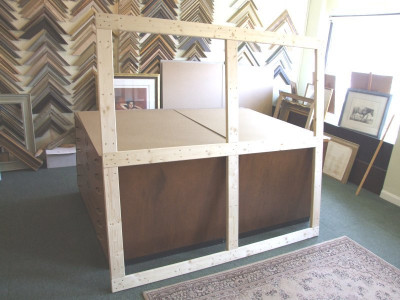

I would definitely use a subframe - and a fairly sturdy one. Also, I would NEVER hang a picture of that size and weight
using cord/wire. Engineer a French Cleat into the subframe and use very deep wall fittings.
Here is a big subframe it did once. As you can tell, the joints are lapped rather than mitred which makes it super strong.
The timber is pine 8mm x 100mm tongue and groove with the tongue ripped off. An economical option.
It is made from two layers stuck together which makes it easy to form the 'laps' and makes it very stable.

I can't sat I've ever cut them down, but no reason not to. The available subframe moulding are probably adequate for most
applications phatically if you take advantage of the bevel to use a French cleat. The subframe in the example I posted also
served to allow me to use four boards to make the backing board the cross pieces align with the joins and the boards were just
tacked on.
