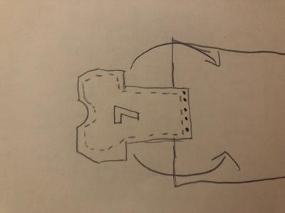

A method I liked is to position the the shirt on the bottom of the board as shown with its insert (dotted lines); tag it (black dots) close to the bottom of the former, then flip it back on to the board and tag/sew the rest.girlfromkent wrote: Thu 01 Feb, 2024 8:22 pm
………What I'm wondering is, how do people tend to secure the bottom of the shirt to the foam? I've seen a video linked to somewhere here which is pretty good overall but then they go and stick the shirt down with fabric tape. What's the better, conservation friendly way? Is it even necessary?

Re: Ways to frame a sports shirt?
Thanks John that's a really helpful tip!
