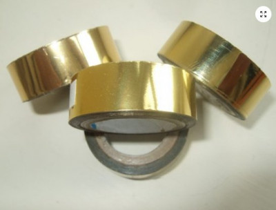

122m of gold blocking foil - https://ratchford.co.uk/product/coloure ... llic-foil/
There's enough foil there to get you gilding to the moon and back.

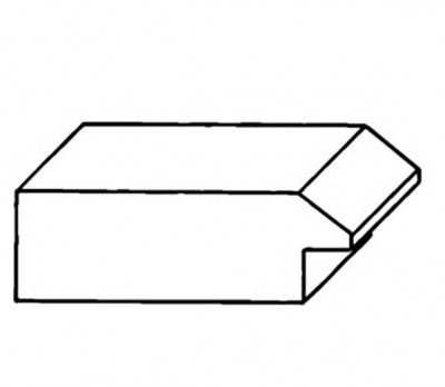

So let's take this plainwood moulding from R&H, A286
Go ahead and paint it whatever way you want, black, blue, yellow or pink with yellow spots.
Now run a length of masking tape across the top so as to expose the front sight edge only. That'd the bit we're going to gild.
Paint this a solid black with the tube of paint.

Cut off a length of the gilding foil.
lay it onto the sight edge and press along firmly with your finger.
Now peel away the foil.

I noticed the delivery charge for one roll of gold foil is -£10.50 and found the following on EBay and wondered if you think this is the same foil?
Regards
Allan
https://www.ebay.co.uk/itm/303527392142 ... media=COPY
Regards
Allan
- Posts: 1553
Re: Gilding for Dummies
I really don't know if that is the same stuff - they do warn that it is only for use with laser printers.
There is this other company -
https://www.profoil.com/product/rpg220 ... oss-foil/
but they too have a delivery charge - £7.95
Both seem to add up to the same £15. Sorry about that.
