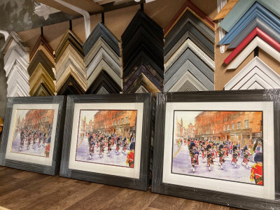

These are examples of deep bevel edges, two with coloured self adhesive tapes and one with the Royal Stewart tartan ribbon. The painting is of the Scots Dragoon Guards marching along Princes Street, Edinburgh. They all went to the same customer, the Pipe Major.
Re: Mat decoration tape
Hi Fitz,
Oh, Wow, they look great. That a really nice job. Now I understand why you were talking about tartan tape!
