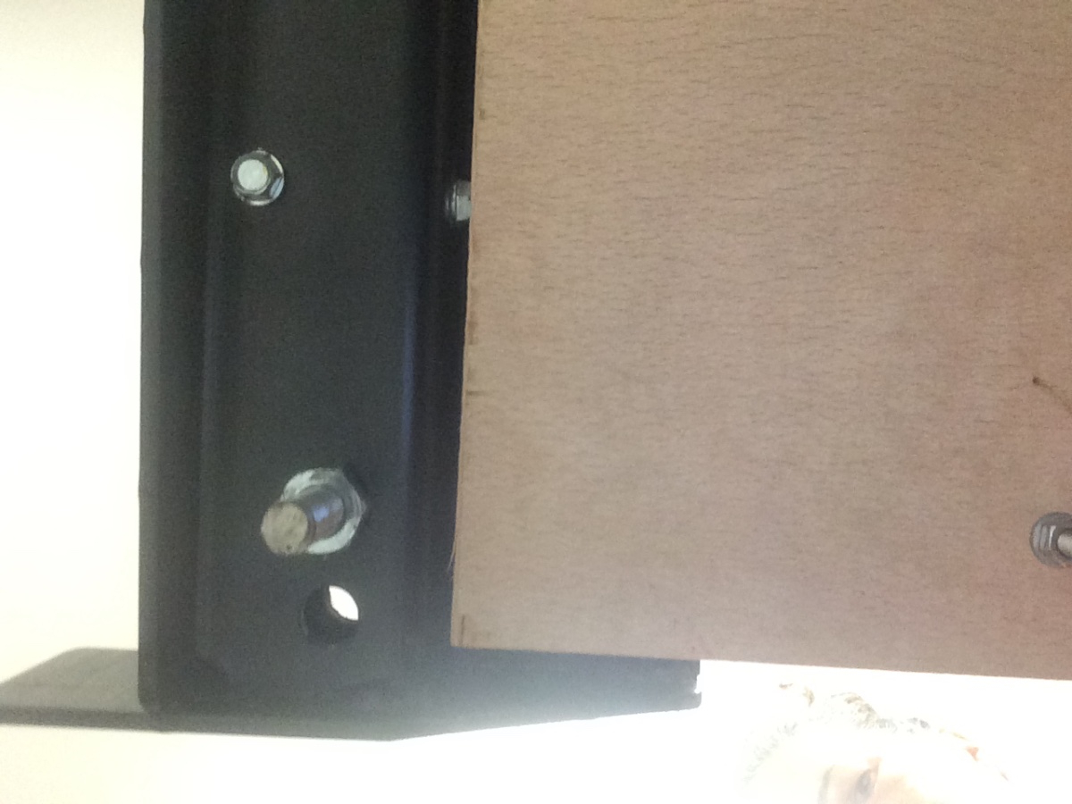

I'm assuming that all parts are there, it certainly looks complete. It's fixed onto 25mm ply which is then screwed down to the top of an AO plan chest, so the unit isn't able to move during use
The underneath of the securing arm has a continuous strip of 3mm dense black foam, so not marks are left of the paper/card
When I close the securing arm there is not a gap at the back end of the arm but as you come forward from about 40cm away from the front edge the gap begins and is about 2mm at the front edge. When I test with a piece of 200 gsm cartridge paper, moving it from the back to the front edge, the paper is held securely and cannot be slid out until I get to about 40 cm away, then I can slide the paper freely under the arm
If I place a piece of 2mm greyboard at the front of the securing arm between the two bars (ie below the arm that has the lever attached to the top and the lower arm that holds the paper to be cut), this closes the gap, and there is even pressure all along the arm, so maybe that will be a fix, but I was wondering if there is an adjustment at the rear of the arm that alters the angle of the arm? Not sure if this is making sense, but I'm wondering if when it was serviced the unit was reassembled correctly, hence the request for a photo of the rear assembly.
I intend to cut 2 - 3mm greyboard, up to 250 gsm cartridge paper, which is when the problem showed itself as I was cutting a stack of paper (about 10 sheets of 160 gsm) and it slid away from the blade, not a good look for the edges of a book
Usually I would cut each sheet of paper by hand, but, there is always a small variation so the machine cut would be ideal if I can get it to stop shifting.
Thanks again for your time

Is there an adjustment for the spring tension on the clamping lever to enable the front of the clamping bar to close to gap at the front. This is likely to be the best way of adjusting this gap, if such a adjustment is available. Beyond that possiblity, I don't have much else to suggest!

Is this an adjusting bolt? It is under the table at the front under the front spring
