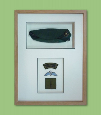

This is one I did that is fixed with tags at strategic locations underneath.
