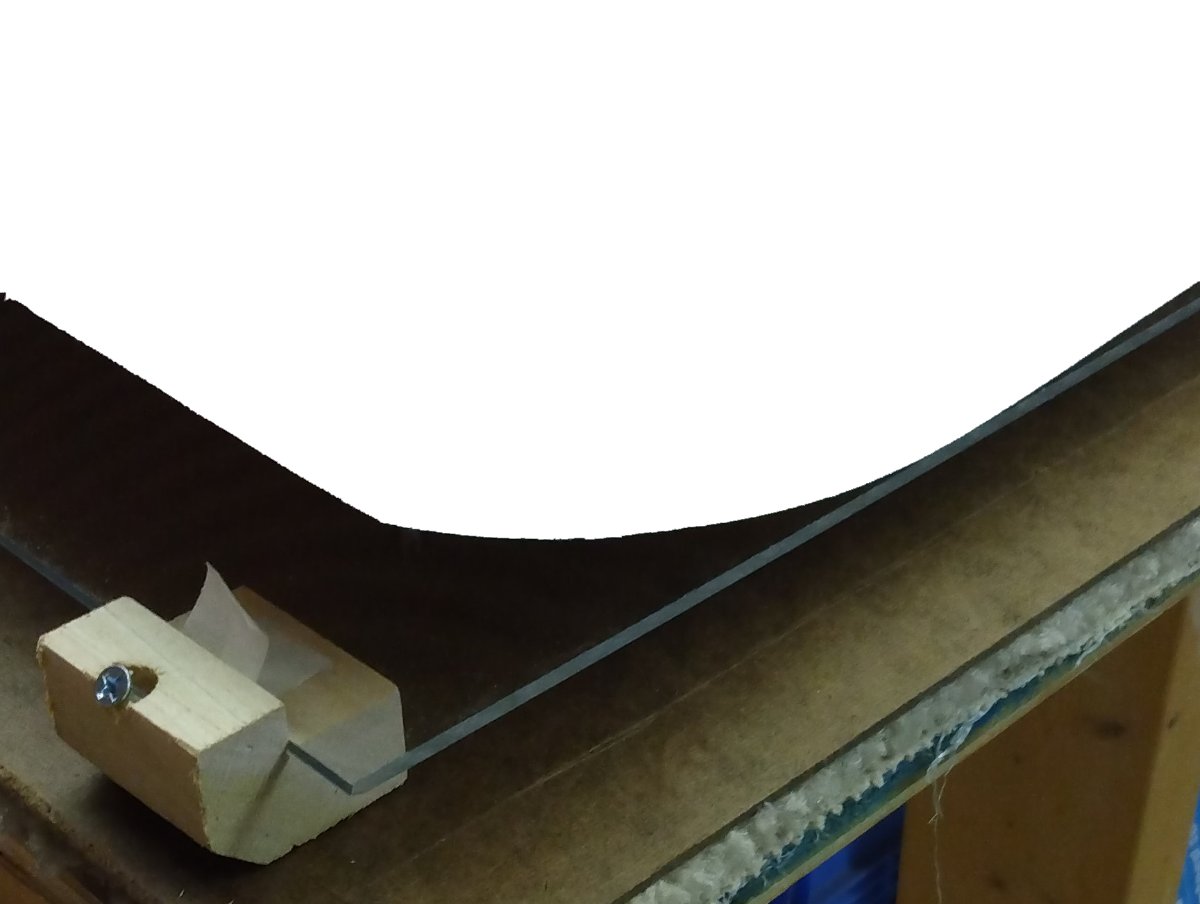

This is what I am dealing with. Note that I have deleted the actual image of the watercolor painting for copyright reasons. The wood block in the image is a support for the acrylic to keep it off the table as there are standoffs behind the flat acrylic sheet. That curl is from the manufacturer of the 300# Arches paper by the paper mill. The paper size is 100cm x 125cm. The artist insists that I make it flat. I do not have a magic wand.
I am using 5 hand torn paper hinges on the top, 4 on the bottom and 3 on each side.
