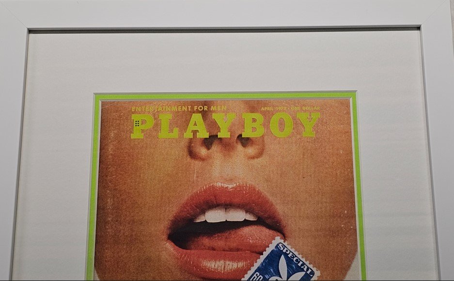

Apologies for the delay in providing an update on the outcome - thanks to everyone for their comments.
I thought that Prospero's comment about the magazine fading was a good one, so with the customer's agreement, I ended up getting the cover scanned and printed. In doing that, the magazine itself can be browsed at leisure. I get where you're coming from Justin, but the magazine was from April 1973 and therefore a 50th birthday present. I of course had a quick leaf through and by today's standards, it wasn't really pornographic at all!
I've attached a photo of the finished frame (top half only as I couldn't avoid reflections)
