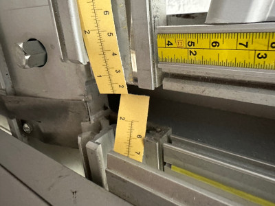

I’ve picked up a used Steeltrak 65”
and it didn’t have a LH or RH squaring arm scale. I purchased both but wondering if anyone has a photo of there’s so I can see exactly where the scales are meant to stick.
Steeltrak Squaring arm scale

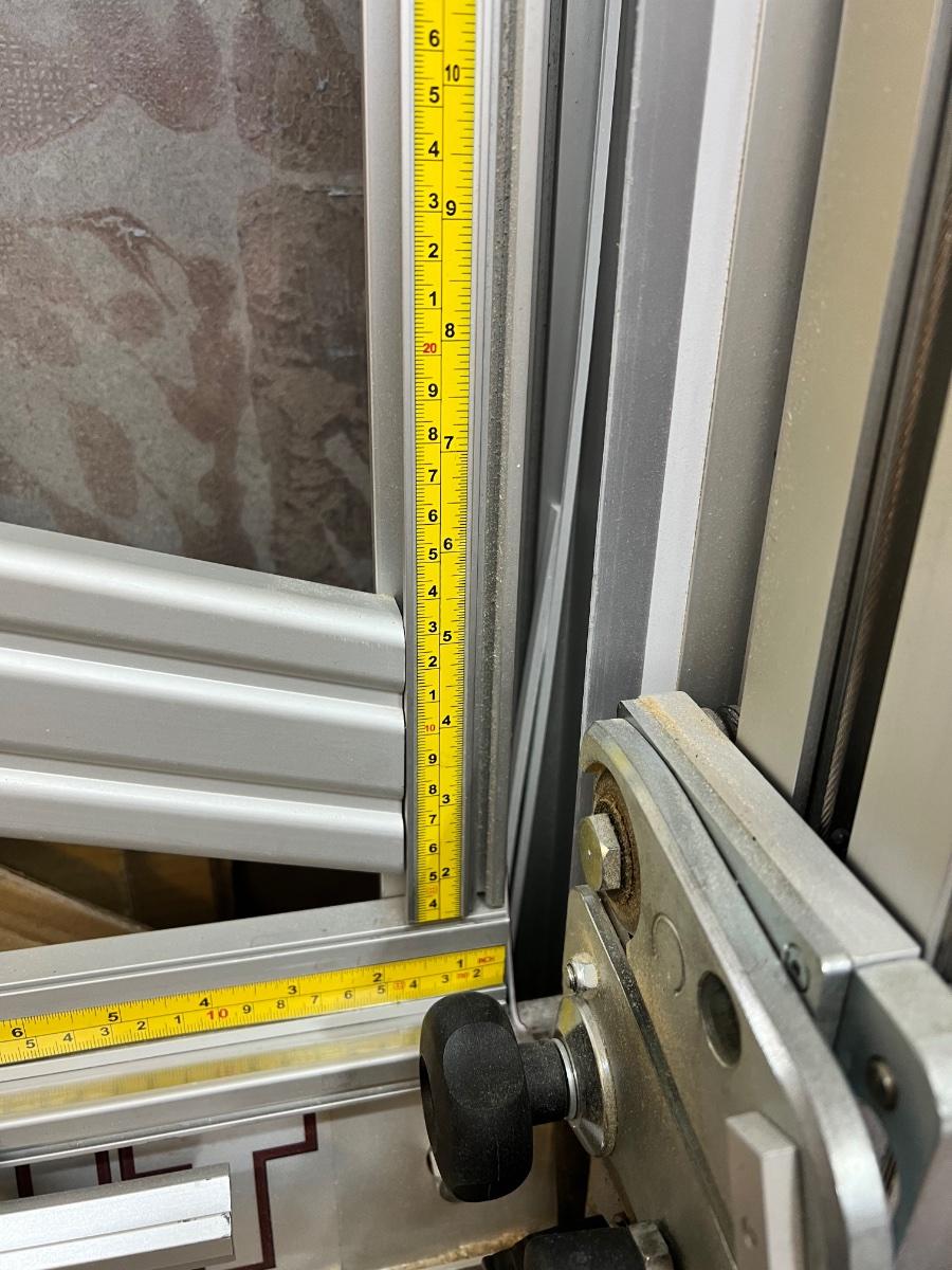

To give you an idea what I mean

Re: Steeltrak Squaring arm scale
I would do as John suggests in terms of calibration. I have attached picture of my Steeltrak in case it is useful for you.
