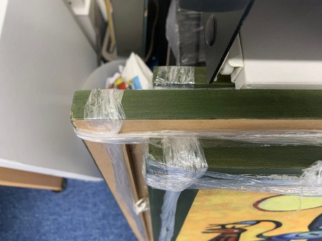

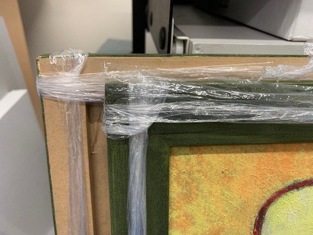

I have a client who wants me to match to the frame pictured.
The frame is dark green and measures 20mm deep x 35mm wide.
I've looked at Lion, Centrado, DJ Simons and Larson Juhl... but no luck.
Has anybody got any ideas where I might find some of this moulding please?

That looks to be a hand finished frame
- Posts: 1481
Re: Help with moulding
'Been ages since anyone mentioned - Handfinishing!
Here's how to do that frame.
The moulding is A40 obeche from R&H.
Make the frame then buy this stain from E bay, Antique Green
https://www.ebay.co.uk/itm/325271062822 ... u2zAEajR
It's a good idea to also buy Walnut and Plum Mahogany. You can use these colours to match the green more if needed.
Think of Walnut as a base colour and use the Mahogany to warm it up a bit.
Apply two coats of stain with a cotton rag and when both are dry, you need to seal in the stain with shellac sealer
https://www.ebay.co.uk/itm/325553247019 ... UL6Nd1sH
You can rub this on with a rag if you wish, or use a brush.
Dilute it 50/50 meths and once again apply two coats.
Next day, rub the finish back with 0000 wire wool, wipe it clean and apply two coats of your favourite wax.
