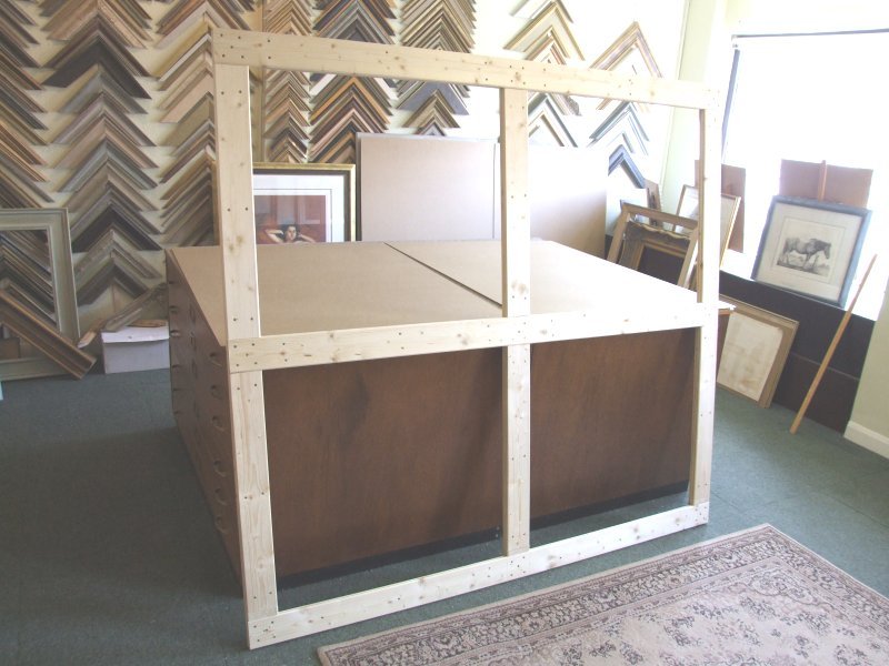

For something that size and with that moulding width you really need a subframe. That is a support frame
that goes behind and takes the weight of the entire inner package. Wessex do suitable sections, but for max
strength you can make your own from PSE timber. It should be the same size as the backing and the hangings
can be strung from it or better still incorporate a cleat system.
On drawback, you need an outer moulding that is deep enough to swallow the depth of the subframe. It doesn't
matter if it sticks out a bit, but not so much that you can see it from the side when hung. The outer frame then
only serves to hold the inner package together and supports no weight.
Here's one I made earlier....
This is made from 95mm x 8 mm tongue and groove cladding with the 'tongue' ripped off. This allowed me to form
half-lap joins by using two layers glued together. Very strong. :)
