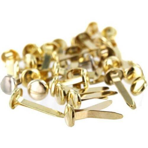

Re: Framing vinyl records and record sleeves
I use these with black rubber washers between paper fastener and record.
Dave
