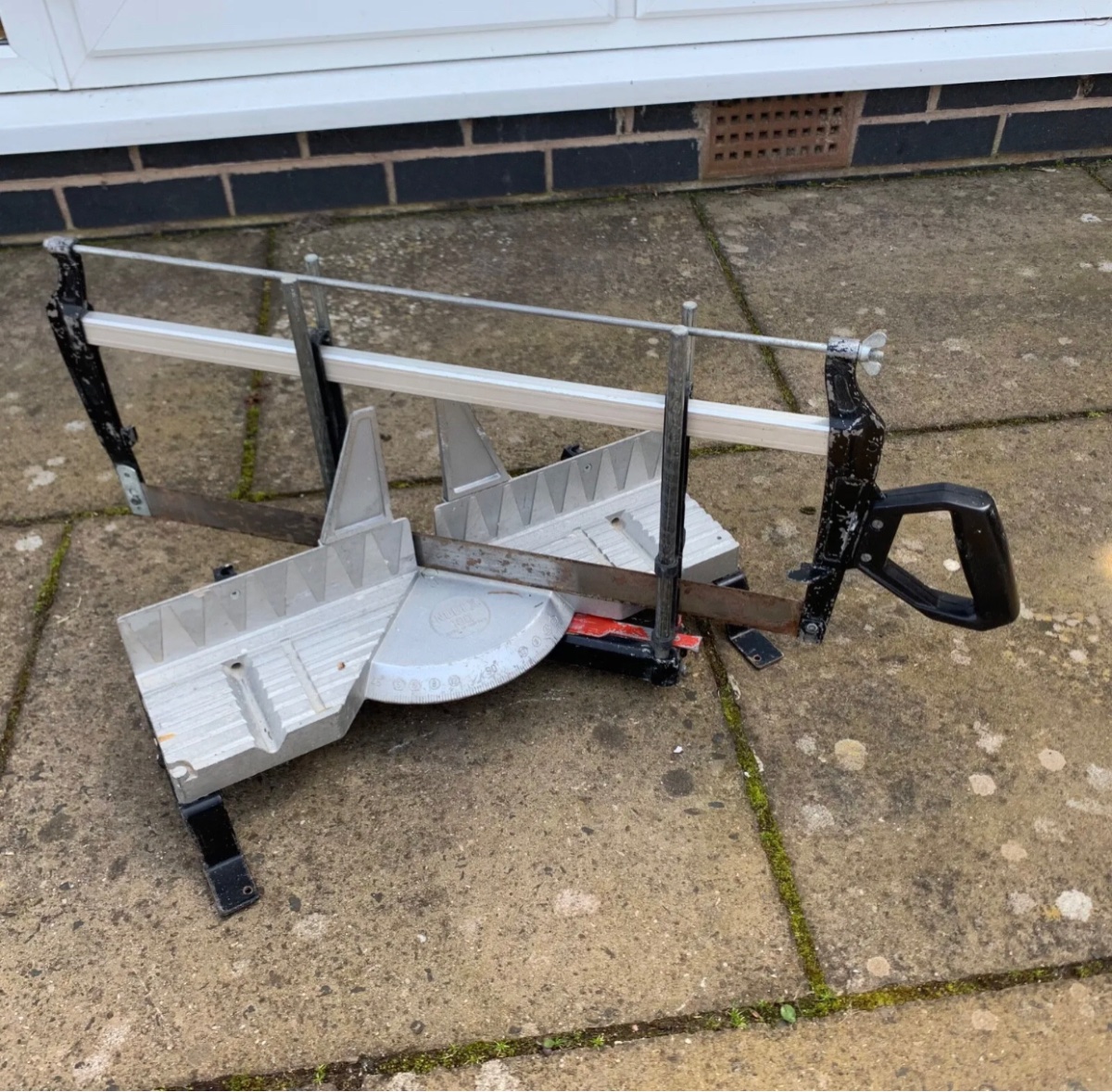

Post by JKX »
Not electric Mark - the guy’s looking at one of these.
