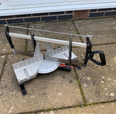

- Posts: 11697
Re: hand mitre saws
I cobbled together this setup for £<500. The only disadvantage is that it needs to be a permanent setup.
It's also very dusty but a good dust extraction system would cure that. I've been using it for ten years and
it speeds up cutting big awkward mouldings considerably. Having two saws avoids the need to swing the head.
And the angles can be fine-tuned like the left fence on a Morso. I replaced the stock blades with 80-tooth ones.
The measuring system is quite cunning and I can set it from 0 to about 7ft.
