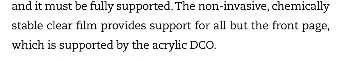

I still haven’t read it all but I did note this

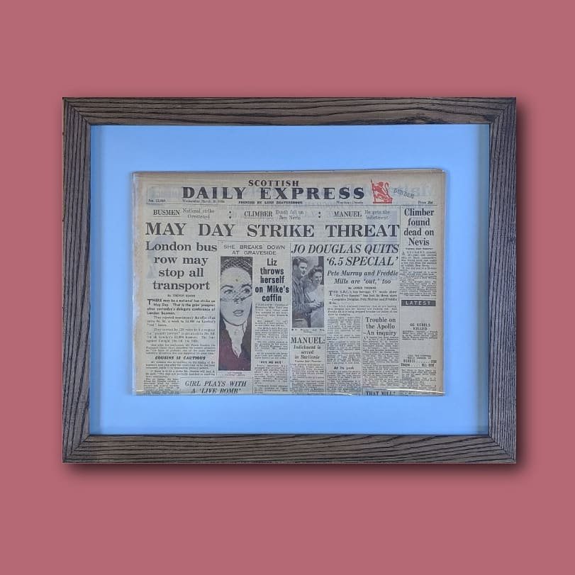

This is one I did using Jim Miller's own method of completely wrapping in melinex and the glass is spaced away from the package.
I think he's made things more complicated using this direct contact method.

Just a question - does the newspaper in the frame you showed, looked wrapped?
Jim Millar's version was to attempt to show a no wrapped effect.
Whether overlaying then with a sheet of acrylic is a better effect becomes another matter.

Nice bit of Optium Acrylic on there and Vintage is right, it will give the effect of it floating without support rather than the visual effect of the wrap itself.

My first impressions were “why fold the newspaper in half”? and “what’s that skinny mount for”?
I had the book describing how Pramsay did it but never really studied that particular method because I simply would never suggest folding a newspaper in half. I did do quite a few, tabloid and broadsheet, and I did them almost like a magazine mount - ie
one vertical wrap of melinex around all bar the front page - then all you need do is prevent it sliding out to the left and the front page from opening against the glazing, and there are a number of ways of doing that including another wrap around the whole thing if it’s not too big.
If it is a bit too big, then the melinex, unless there’s heavier weights than I ever used, will be too wavy and reflection becomes an issue.
Now there’s this other method - direct contact with the glazing, there would have to be absolutely no other way for me to do that, regardless of quality of said glazing - and there are other ways.
It has to be acrylic - dearer than glass, it should also be abrasion resistant, dearer still - then of course UV is desirable - getting worried now - then optically coated - so now we’re talking optimum museum - for my customers - on a newspaper, that would be out of the question - probably would be a few commas back too!
Cost effective and option museum don’t appear in the same job here I’m afraid.
I also thought DCO using wadding like that was the actual mounting method - something pushed in to a ‘pillow’ - usually something very light. But this is mounted with melinex wraps and straps and all that’s left to do is prevent the front from flopping forward from the top right.
