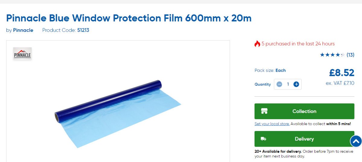

Cover the glass in this stuff from Toolstation, so if it does break, the glass is still held in place,
